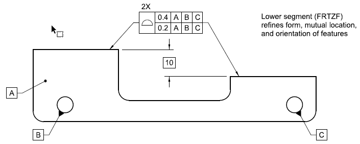

Hi All
Can any one explain exact difference between composite and multi-segment pos tolerance, is Multi segment used for refinement of uppersegment ?
in both lower segment controls orientation and feature relation then what is the difference and how to choose which one to use with same datums.
refer images from asme y 2009 and list the difference pls
image from fig 7.39a and 7.46 c
 https://files.engineering.com/getfile.aspx?folder=d1a254b5-0999-4a3c-8eda-8566d4e384be&file=composite_tol.PNG

" Each complete horizontal segment in the feature control frames of Figs. 7-38 and 7-39 may be verified separately." (Y14.5-2009, 7.5.1 Composite Positional Tolerancing).
Evan said:
B and C both participate in constraining the w rotation.
I disagree. When the part is engaged with only the A and B simulators, the W rotation is free. Only when the C simulator is engaged, W is constrained.
That the sequence is meaningful is always true, but it doesn't make the B simulator take part in arresting clocking.
Consider it without the MMB modifiers for clarity of the principle that applies:
A,B,C is not like A,B-C.
"may be verified separately" doesn't say the datum requirements are separate.
The feature relating frames and related tolerance are necessarily separately verified.
Vague language with multiple interpretations not supported by the figures and examples.
Thanks Burunduk for again showing an example of the carelessness in crafting the standard.

I say it is. You are this time right about the relevant degrees of freedom for each datum. But remember that the reason translations are not controlled for the FRTZF is because the tolerance zones can float in location (as a group), not because the datum feature simulators work somehow differently. Evan mentioned this recently in this thread and I also pointed this out in the past in this forum. As Evan also mentioned, it works like orientation tolerances do. The datum simulators immobilize the part as usual, but the tolerance zones of the "FRTZF" can move.
If you evaluate each segment of the composite separately, you can set the part up for inspection on the datum-simulating fixture separately for each line.
So for the top segment you may get something along the lines of Evan's second picture, but with the zones aligned with the DRF,
And for the lower segment it could be Evan's first picture.
pmarc - as asked before:
If they are separate, then why the restriction? What purpose does it serve?
Burunduk - another case of taking a statement out of context. Your favorite argument tactic, but weak even for you.
When I specified that ONLY THE FEATURE RELATING FRAME AND RELATED TOLERANCE WAS VERIFIED SEPARATELY, I meant it.
Feel free to comment on what I wrote and refrain from creating your own fictional basis for response.
Burunduk,
I maintain that B participates in constraining the w rotation. When B is not referenced, the w rotation is constrained differently than it is when B is referenced - the diagrams show it. This means that B must take part in constraining the w rotation in some way. I don't think that
I'm also not suggesting that it should be A|B-C instead of A|B|C. That would result in a different DRF. In the case where there were no MMB modifiers, A|B-C would require that the B and C simulators somehow expand at equal rates to ensure that neither one took precedence over the other. I don't know how that would even work. The A|B|C reference is fine as is.
I think that what this does mean is that Y14.5's breakdown of degree of freedom constraints might be somewhat limited. We're not always able to step through the datum feature references one at a time, and identify all of the DOF's that each one really constrains. Maybe this is only true for rotational DOF's, so we see it when examining composite lower segments.

Burunduk and 3DDave,
Y14.5's use of the word "separately" in 7.5.1 is another unfortunate example of loose terminology making things even more confusing. When they say that each segment in the FCF's in 7-38 and 7-39 may be verified separately, this is nothing to do with the concept of Separate Requirements from the DRF section. It would have been better to say that each segment may be verified independently. Wait, that might get confused with the Independency symbol. Perhaps "verified individually" might have been better. No, wait, that will get confused with the INDIVIDUALLY annotation which is similar to Separate Requirements. Let's just say that you can verify one segment without having to verify the other. ;^)
Regarding a simultaneous requirement (or lack thereof) between the upper and lower segments of a composite FCF, I don't think that we need to apply the rules any differently here. In most cases, the upper and lower segments would be separate requirements because they usually don't reference the exact same combination of datum features. But if they do, as in 7-42, then I would say a simultaneous requirement would apply.

There are three parts to a feature control frame composite callout.
The common geometric characteristic
The feature relating frame as established by dimensions between features
The optional datum reference frame as established by dimensions to and among datum features
Each segment of a composite tolerance has at least the first two, with the geometric characteristic being common and indicating that every same lettered datum reference in each segment is from the same, top level, datum reference frame.
Each feature relating frame is separately evaluated.
The PLTZF is a combination of the feature relating frame and the datum reference frame and is used as a basis for evaluating the top segment tolerance zone. It both locates and orients the feature relating frame to the part.
The FRTZF is a combination of the feature relating frame and, if there is any, the retained elements of the datum reference frame, and each is used as a basis for evaluating the relevant segment tolerance zone. It only orients the feature relating frame to the part.
Not the same datum feature separately evaluated; that happens just once. Just each feature relating frame.
Evan, it cannot be a refinement of a requirement if the basis for that refinement is allowed to change.
If it is allowed to change then the requirement for the order being the same, but not all the entries, seems like a needless restriction.
The FRTZF is not related to "retained elements of the datum reference frame" but to the datum reference frame established by the datum references in that same segment. The principal difference between the top segment and any subsequent segment of the composite tolerance is in which degrees of freedom are considered for constraining the tolerance zones to each datum reference frame. It is only rotational DOF for all segments other than the top.
Each lower segment is a refinement of the controls already established by the segments above it - that's why you need the order maintained and no skipping of the secondary reference if the tertiary is kept.
