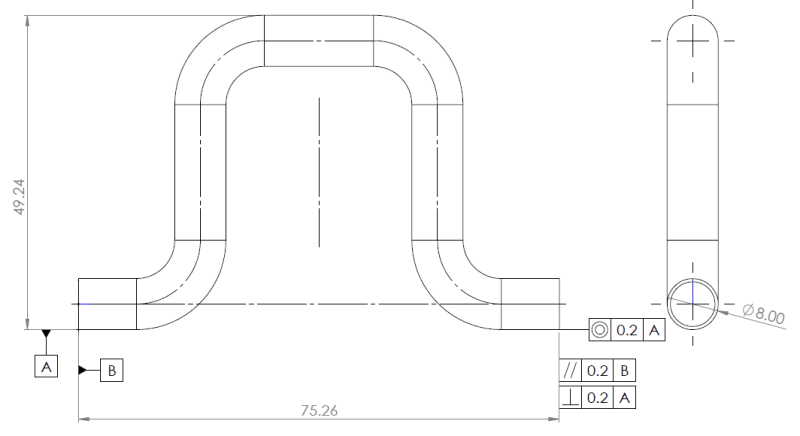

I am currently going back and forth with one of our engineers regarding how I read the drawing and the setup for inspection to the engineer who has revised this drawing (Not the original drawer).
Below is a roughly drawn part, fairly similar to what I'm working with.
The way I read this drawing is: DAT A is the cylinder it's connected to and DAT B is the end plane - As the image displays below.
I have queried the DATUM intent from the engineer and he has told me that this is supposed to be read as DAT A being a line taken from the "Highest point" of this tube side profile across both parallel cylinders and DAT B as the end plane. - As the image displays below
So we're both on the same page (fairly obvious) with DATUM B. It's DATUM A that is confusing. We're working to ISO 8015. I have been reading up on this throughout the day and I believe for the drawing to read how it was intended, the line requested should be marked with DATUM target points creating a DATUM target line.

So, your interpretation cannot be possible. Datum A cannot be referenced from something else in the drawing that is not a datum, but that's a semantics thing, i.e., the highest point is referenced from datum A, not the other way around. The concentricity seems misapplied, since datum A is most likely a plane, particularly since the highest point is measured from it.
TTFN (ta ta for now)
Apologies, the datum A should be offset from the distance leader line.
By me saying DATUM A I see as the cylinder I mean the cylinder axis incase I've left any confusion.
What plane is it you're seeing as DATUM A? I see it that the concentricity/coaxility callout has just been placed in a way causing ambiguity and should be the opposing cylinder thats coaxial to the one marked with datum A.
I cannot make no sense of the coaxial callout if a line is supposed to be created along both of the cylinder sides for datum a? Where is the start and end of this line to measure against the referenced datum?
I've always understood the axis of cylinders to be the datum unless stated otherwise through target points? I could be majorly off but I don't believe this differs from ISO + ASME?
Per the drawing, datum feature A is the width dimensioned 49.24.
It is worth noting that, given the cylindrical features involved, that there is an assumed orientation of the part. Assumptions of this type often go unnoticed because the inspector will usually just drop the part onto the granite slab and start to work. However, contact with the granite slab establishes a datum feature that is not mentioned anywhere on the drawing.
This should be explicit and, in the case of formed tubing, might benefit from setting up datum targets to avoid the part rocking during inspection so that sequential parts can be rapidly validated.

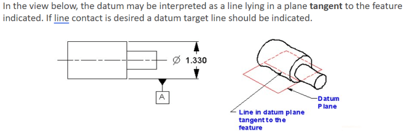

I've understood for this to be only the contacted surface considered for the datum when the datum is offset from the distance leader, as shown below:
To follow up on my message yesterday

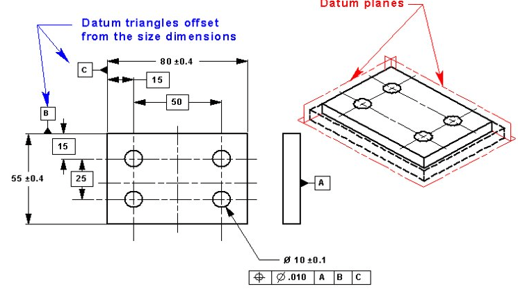

This image below shows a similarly dimensioned part but mine doesnt have the diameter dimensioned in this position - Although it does have the diameter in the other view
It's round so any tangent on the round surface can be [A]. It's assumed to be also perpendicular to the viewing direction, but that isn't well defined. Like, picture holding the part and eye-balling which of many tangents is the one tangent you need. So the part gets placed on a granite slab and the orientation isn't set by a reference on the part, but because the CMM operator just chose that way to put it.
In the cases you show, the flat faces have a unique orientation, so that works, and references such as [A|B] assume that B is perpendicular to A; but A is flat.
In this case the tangent is not oriented to anything. So picture the part setting with that U-shape up away from the granite slab and the CMM operator balancing it. Nothing holds that tangency in place.
Finally - concentricity cannot apply relative to a plane and it's sketchy to apply it to a tangent line rather than a diameter indication for a round tube.
Is there a functional goal for these features? Just giving the two end segments a common profile of surface tolerance would set the allowable variation much better. Even a position tolerance would be more in keeping with the usual functional goal.

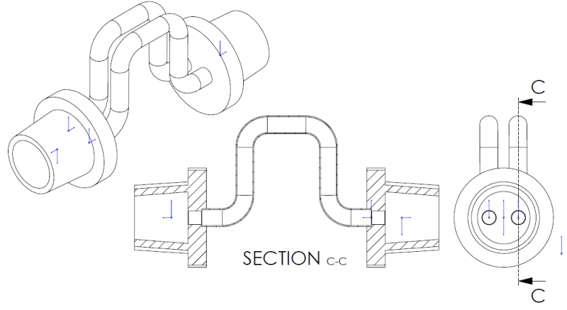

I have put together a quick assembly which replicates the actual use of these parts here. Im not sure if this will give a better understanding of the initial component from this.
Then either position or profile can be used. You can also indicate that the small areas on the ends are the only portions that matter.
Your followup with tangent line came while I was typing, so I did not see it. The problem in that is that every tangent line all around the fitting has a plane - there are an infinite number of orientations that concentricity doesn't apply to.
You should be confused because the drawing doesn't make sense.

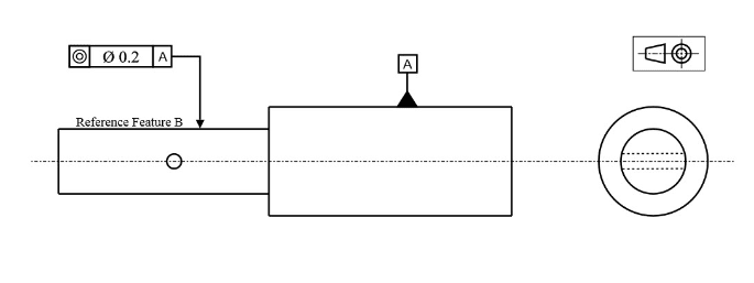

The engineer has come back now acknowledging the drawing isnt up to scratch for the intentions. Im still struggling to understand how the DAT A isnt considered a cylinder in the way its been dimensioned on the drawing as its fairly similar to this image below, although the referenced feature is connected to the Datum this is dimensioned the same as the part im working with.

The datum feature symbol can be moved to the diameter dimension and be entirely unambiguous.
Is there some reason to remain ambiguous?
Use to describe the size at one end with the areas that interface to the mating parts marked A:
2X Tube diameter MARKED A
[position tolerance|(dia) tolerance MMC]
where tolerance is the amount of diametral clearance allowed by the mating part at its MMC condition
and that will create a simultaneous requirement for the two ends.
In addition, both ends fix the orientation of the part so it should be that each diameter gets a diametral indication, rather than tangential, of a datum feature symbol, such as [A] and and then the perpendicularity would be to [A-B].
Concentricity is the worst choice for this feature control. I'm confused that anyone would choose to use it.
What is especially sucky is that the orientation of datum feature B relative to datum feature A is driven by the parallelism tolerance on the other face, a face that is also controlled by perpendicularity to Al this complex chain rather than making both ends being perpendicular to A.

Hi, J-Hendry:
Your data feature A (be it cylindrical or line segment) is too short to qualify as a primary datum feature. You will need common datum features to define datum A. I don't know if common datum feature is a valid term in ISO 1011. In ASME Y14.5-2018, it is at section 7.12 (page 77). There should be something similar in ISO.
Common data features mean that both ends (cylinders) are used together to establish datum.
