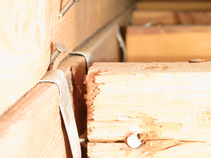

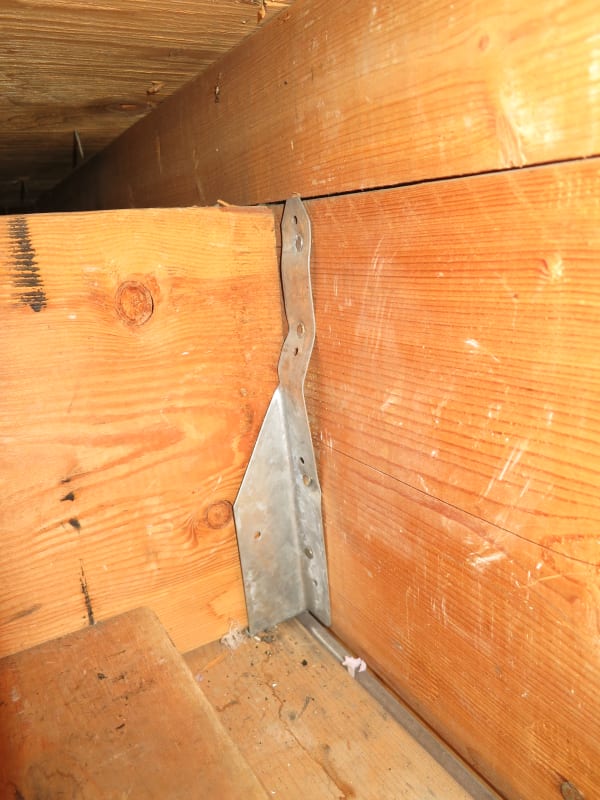

I am on the board of directors for small condominium in Canada. The building was built in 1979, it is wood-frame construction and has a flat (i.e. low-slope) roof.
Recently we had a roof consultant inspect the roof in preparation for replacement of the weatherproofing membrane, that covers the roof, next year. When looking at the framing below the plywood deck of the roof the consultant noticed what he described as questionable construction work and recommended that we hire a structural engineer to check it out and determine it's structural integrity.
The consultant made his observations of the roof framing from a hatch opening that penetrates through the roof structure making it possible to see below the deck. I have attached four photographs taken on opposite sides of the hatch opening, looking down the cavities between cross-strapping members that support the deck. On the photos I have indicated the consultant’s comments about the construction work.
My questions for this forum:
What do you think about the quality of the construction work shown in the photos, specifically the attachments between the components of the roof - the plywood deck, the tapered 2x4 cross-strapping members and the 2x10 joists?
Does it look like typical construction work for a wood-framed building?
Do you think the consultant’s comments about the structural integrity of the roof are justified?

To the OP, your inspector has raised some potentially valid concerns that require further investigation to be prudent. For starters, much better visual access to a representative sampling of the existing conditions would need to be provided (i.e. selective demolition and/or removal of finishes).
I’m told some inspection holes would need to be cut in the deck in a few locations to get a more complete understanding of the construction work on the sub-structure.
I would have thought that a boroscope would be used which would be far cheaper and easier to repair, since it could be done with only a small hole drilled through the deck.

I like a note on drawings that says to fill all holes in joist hangers with specified fasteners, unless noted otherwise. To me, open holes in joist hangers is always a red flag. That being said, Simpson lists multiple capacities for some of their hangers depending on how many nails are used to install. In that case, you should be able to at least expect to to see symmetry of the nails and open holes in every joist hanger. Haphazard nails and open holes from one joist hanger to the next is again a huge red flag of possible shoddy construction and workmanship.
Thanks for pointing that out.
From the photos it looks like the holes in the hanger flanges aren’t used at all. Rather, nails are shot right through the metal of the flange into the supporting joist.
Also, one hanger has the top of the flange bent over the top of the supporting joist for some reason.

The problem is it is actually very difficult to answer the question ‘Is this roof structurally sound?’ because the structure of the roof is not visible. Even if as-built drawings of the original construction are available, it doesn’t guarantee that it was built that way or there hasn’t been any deterioration or damage since then.
The question can really only be answered with a certain degree of uncertainty. So, in order to get the degree of uncertainty down to an acceptable level, the engineer may feel they need to either see a certain amount of the structure which of course requires penetration into the roof, or recommend repairs that may actually not be needed, or both.
The direction it could go is wide open, from nothing needs to be done to replace all the hangers, install attachment plates between the joists and cross-strapping and re-do the nailing between the deck and plywood, and I think it depends to a large degree on which engineer is doing the inspection.

There is no evidence of structural problems, there is evidence of inexperience and slop, and corner-cutting haste, which are problems if they become problems.
I can say that these shots show haste and slop, but no apparent weaknesses

Why are the hangers bent?
—These are the incorrect hangers. They were installed after the carpenters hung the joists by an *apprentice* in a very dangerous and incorrect fashion, using an air nailer. The hangers were bent on installation to keep them from protruding, because they are too long.
Why is there separation at the joists?
—Because they were cut short.
Why is there deficient toenailing?
—The apprentice couldn’t toenail with the nailgun to save his life. But it was good enough to get the job done.
Why are nails protruding from the plywood?
— Apprentice tasked with nailing off plywood made a mess of it.
Are any of these above items structural engineering problems?
-Yes, No, Maybe. Ask an engineer.
