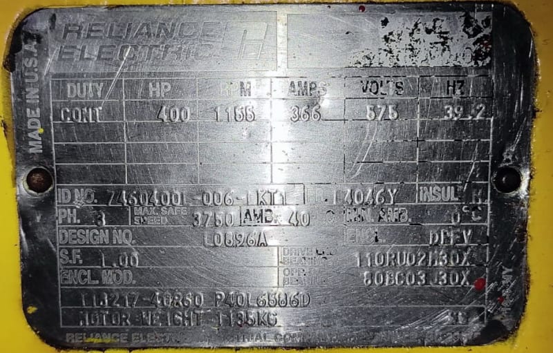

BTW, is it about 250 kW motor? Attach a nameplate photo, please.
zlatkodo - Got it. Can't do long jumpers with poles = parallel paths or odd no. of parallel paths.
Under discussion motor NP below.
Muthu

This motor has a specific base frequency - 39.2Hz.
Maybe it's good to check if they programmed VFD base frequency parameter with this value.
