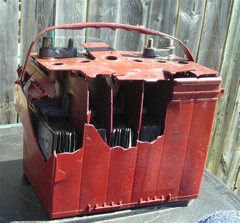

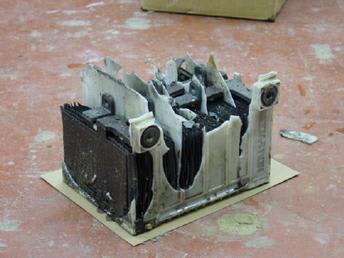

Sparweb said:
Sometimes it sounds like everyone is discovering all the problems and headaches that come with batteries, they're just named differently today.
I must disagree. While a lead acid battery can provide the energy to heat a high resistance fault to the point of fire, the battery itself is extremely unlikely to catch in fire itself compared to other technologies. I will also add that the mag-amp chargers that work so well with FLA batteries are highly reliable and less likely to contribute to problems.

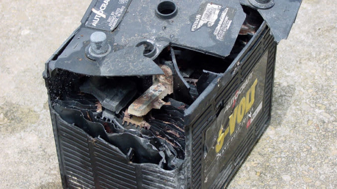

What's this a picture of?
What happened to this?
Again?
NASA Spotlight on Lessons Learned: Battery Explosion
Link above said:
A lead acid battery used to start an emergency generator burst for no apparent reason and spread sulfuric acid near the generator. On May 17, 2010, the shell on the Generator No. 1 start-up battery broke and left acid and fragmentation in the area around the diesel generator.
Lead Acid batteries in emergency generator service with automatic float chargers fail often enough that we put them in heavy duty battery boxes. This is not really noticeable until you have a large fleet of portable generators.
I have seen one of these battery fires, they can get ugly if they catch sound proofing material on fire.
I disagree with NASA's recommendations.
My solution;
Don't connect a float charger to a standby generator.
I have installed a lot of standby generators and seen a few exploded batteries.
Consider:
With no float charger, eventually the battery will fail and the generator won't start.
With a float charger, eventually the battery will fail and the battery will explode and the generator won't start.
After a number of battery explosions I disabled the float charger whenever I installed a generator.
I have never had a battery explosion in a set with no float charger.
Monthly test running is adequate to keep the battery charged.
As the battery nears the end of useful life, it will take longer to start the engine.
Been there too many times, and more times then NASA.
ps: Sparweb's pictures could have been from one of my gen sets.
