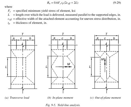

I am not doing any model for the YLM since i don't know how they will be with a rectangular plate with a hole inside. I am just using the formula from the figure 9-5 of the AISC and comparing the available shear strength Rn with my applied load.

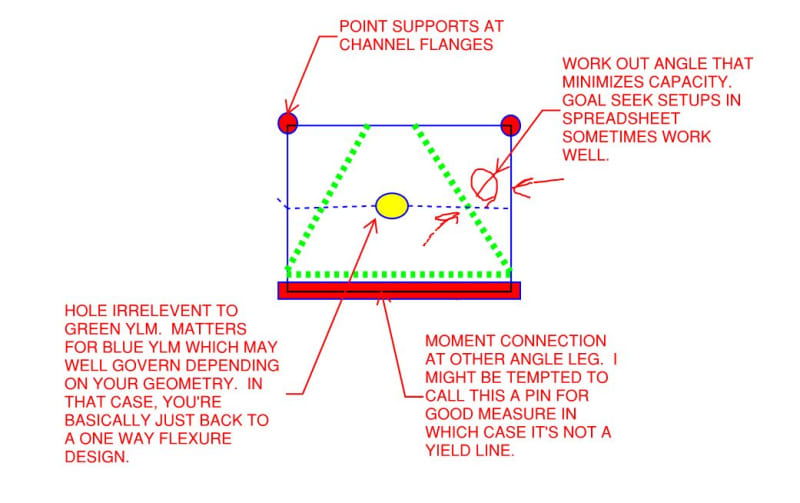

So what i understand from the yield line method, once the yield lines have been established ( i will use the green lines from your sketch at 45 degree angle), i just need to solve for M using external work=internal work.
Mostly right. It's important to recognize that YLM is an upper bound capacity estimation method when what we normally like as engineers is a lower bound capacity estimation method. The consequence of that is that you often have to futz around with your YLM model geometry to ensure that there isn't a version that would predict a lower capacity than the version(s) that you've been studying. I don't know with certainty that 45 deg angles gets you that in my model. That's why, in my sketch, I suggested that it was a parameter in need of examination.
And, like I said earlier, it may well be the blue yield line pattern that governs this.
I checked out figure 9-5. I would say that, in general, the method described there works. At the same time, I don't feel that any of the yield line models actually shown in that figure are a logical fit for your design situation.

I am using the yield lines you have drawn in green to calculate the yield moment. I noticed that my hole diameter is actually quite big and anything will have to go through it.
I don't know if i should ignore that fact and consider it intact.
I think that you need to consider it for the BLUE yield line mechanism which may well govern over the green.

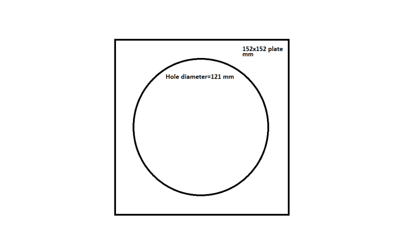

This is the true dimensions of the whole and plate.
Oh my... that's going to be pretty much worthless.
What's the nut thing look like for this?
What's the hole in the angle look like? It may be all that you really have to work with here other than whatever load spread the nut thing may give you.

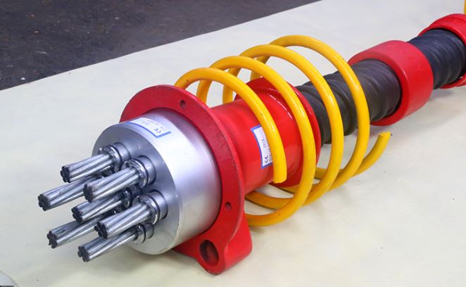

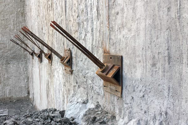

Any chance you could scare up a pic of the anchor?
Yes. that is exactly it. the dimensions are also accurate.
The plate dimensions are standard for this type of strand anchor as i understand.
As I see it, you pretty much need to span that first span in the load path with the nut itself. If so, YLM will not be a useful tool for this part of the design and I see the beginning of your load path behaving more like the sketch below.
So this is what you're analyzing, just with a pipe instead of a spreader plate? Are we safe to assume the 121mm hole diameter is common to the anchor plate, the angle, the channel and the pipe?

it is common practice to use 7 strands with the configuration i have shown and some people i work with do it as the norm.
I added 2 more strands so i am stretching it a bit.
