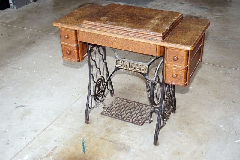

Six years ago I did a full restoration of a Singer 66-4 sewing machine which was manufactured in 1927 (for a more comprehensive review of the restoration effort, please visit Singer Sewing Machine Restoration).
That being said, the lower framework of the sewing machine base was made of wrought iron, as seen in this photo (taken before I started the restoration):

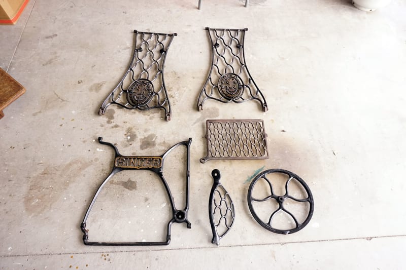

And here were all of the pieces before I took them to the sandblasting shop to get all the old paint removed:
May 2016 (Sony a6000)
When I went to pick-up the sandblasted parts, I was told that I should get at least one coat of paint on them within 24 hours, otherwise they would start to rust. I put my first coat of primer on them before I went to bed that night as I was taking no chances.

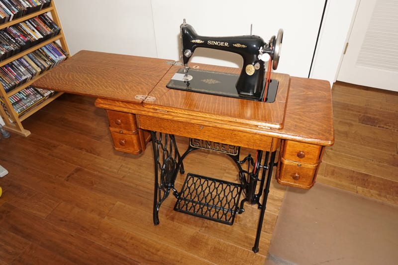

BTW, this is what the fully restored sewing machine looked like when I was finished (as I said, if you want a more detailed review of the entire restoration project, click on the link I posted above):

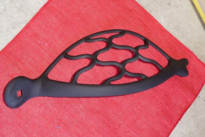

John...is that wrought or cast?
I think it's best to remove the old stuff and use a proper coating system.
They might have been sand cast, but whatever the case, they were Iron and NOT steel. After the sandblasting, the material was very dark, almost black. This is one of the pieces, after sandblasting, but before I primed it:

I also have one of those singer sowing machines, probably the same model as Mr Baker. My bet is the frame is cast iron, rather good quality. There may be a high demand for artistic wrought iron (touched by a blacksmith), but there is no commercial source for actual wrought iron, and no active ASTM numbers for the material.
