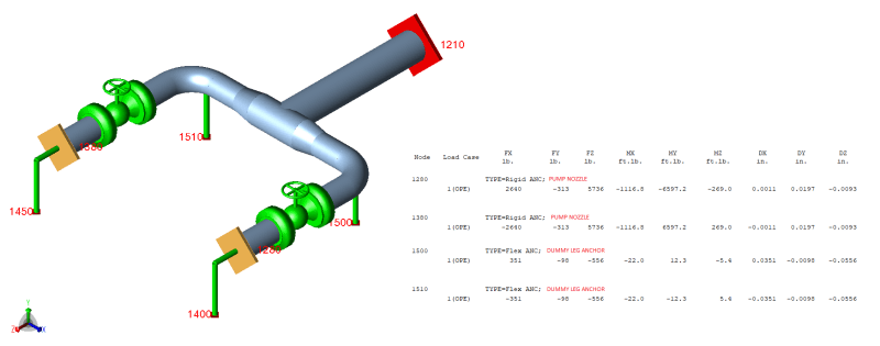

Hello All,
I am new to pipe engineering, and I am trying to do pipe stress analysis to learn the software(Autopipe). I would like to get your opinion on routing the followng pipe based on your experience to reduce the nozzle load on the centrifugal pumps. I would also appreciate if you could point me out to good resource for pipe engineering best practices.
Info:
Medium - Water
Ambient temp - 15 C
Temperature - 95 C
Material - A312- TP316L Stainless steel schedule 10
Pipe Size - DN150
Pump Suction - DN65
Constraints -
Pumps and tank cannot be moved
Height of the pipe cannot be altered, any expansion loop must be horizontal
Pumps may run in any configuration i.e. they can run simultaneously or may work on single pump(either or)
Prefer not to use expansion bellows
Layout drawing attached. Any help/advice would be appreciated.
Thanks.
[URL unfurl="true"]https://res.cloudinary.com/engineering-com/image/upload/v1714961534/tips/0092_001_jfmqym.pdf[/url]
For reference I ran a very quick and simple pump suction model - basically coming straight out of a tank (ignoring those loads) and going to a suction header to the pumps. Modeled the pumps the way I normally would with rigids and modeled the suction piping dummy leg anchors as rigids as well with 1E4 stiffness on the anchor at the bottom of the dummy leg.
The pump nozzle loads aren't terrible given the pipe anchor flexibility, but those loads are still much higher than the published values for a Goulds 3196 or similar type of process pump. And if there becomes a damage/warranty issue and the model shows something like this, you have no outs.

You have inherited an extremely poor equipment layout. Three feet between pumps. That's unheard of.
Anyways, you say 6" pipe to 2.5" pump nozzle. Review line size reduction based on flow at tee split.
From Pump, do size reduction, minimum straight run, and turn away from the pumps, so you can create flex between pump and tank.
First try, go out 3 feet from pump line and turn, next leg towards tank run 6 feet. Join lines together at tee.
At this point run this wing loop shape for your hot/cold design conditions, restrain tee 4 sides.
Once you get the loop between pumps to be close, run the pipe to the tank with a loop to suite.
Also, thermal analysis on hot tanks and vessels is taken from the center line, after all it does grow with heat.
Good luck

I have routed the pipe by 180 deg from the pump suction(with a straight run) and placing the anchor as KevinNZ suggested and as Mike suggested (a wingloop shape) to reduce the nozzle loads at the tanks.
Thank you for all your valuable suggestions.

Agreed with XL, my experience is similar. Clients just dont want to take the time to do things A -> B any more and/or the people who actually knew the process are gone. The newer process guys are just putting out fires and trying to tread above water before typically leaving.
Sometimes when anchor bolts are set or the pump and motor are installed "events" overcome the installation drawings and surprisingly large misalignments between the pimp flanges and piping will result.
If possible, an inspection "hold point" immediately before the piping is bolted to the pump can cause some problems at installation before commissioning.
Those problems generally are much easier ( NOT EASY) to deal with efficiently at the time than after the piping is pulled into "alignment" with come-alongs and the flange bolts are tightened and everybody goes home.
I'd say Designing the piping close to the pump with flexibility and adjustments is a real good idea.
As others said anchors close to the pump to handle the piping forces is a real good idea.
For fun, look at the stiffness of the flexible fittings you may be considering.
Sometimes the pump flanges need to be protected FROM them because the pump will not be protected BY them.
@LittleInch could you explain your modeling technique with anchoring/line stop close to the pump nozzle and flange as free ends? Using the nozzle limit check function it has to be applied to an anchor so how would I be able to check the flange? How can I review forces on that node with no restraint?
