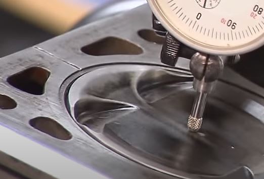

What are those small deck ridges ? ( bmw f1 engine 1500cc 1200hp)
I am inclined to favour Moose's suggestion - maybe someone could ask BMW why they had grooves?
BigClive.
The block is a non-sleeve cast iron design used in BMW road car engines (M12). (Observations and opinions start here.) When modified for F1 any sleeves added would have to be "dry". (I don't think this was done). A wet sleeve system needs the block designed that way from the ground up so this was not a wet sleeve system.
The counterbored cylinder can only be to accommodate a metal o-ring - the M12 gasket in the above link would not work. The grooves clearly run from said o-ring to atmosphere. The purpose can be deduced and coincides with the information that was disclosed 38 years ago.
For those not familiar with o-ring decks. The "o-ring" is the only seal around the bore ie it extends from block to head face with no gasket material. The head gasket covers the remaining head surface. The o-ring is usually copper with flat sealing faces top and bottom.
Alternatively it can be a hard material eg stainless steel or inconel with a knife edge on top to "bite" into the cylinder head. This design will accommodate more dimensional variation eg under high thermal gradients. (0:23 in the video shows a flat cylinder head face so the o-rings were also flat).

The relief grooves were not present on the original Formula 1 engine either. This was a revision to the design introduced after instances where head gasket (bore seal) failure led to dnf's after the coolant was ejected by combustion gases blowing across the deck and into the water jacket. The F1 turbo was probably also the only variant to use "o-ring" bore sealing.

That is an M12 gasket - it fits no other engine. (M12 head gaskets do not fit M10 heads). The o-rings are not separate; it's effectively an MLS gasket with a foil-wrapped rectangular section 0-ring integrated across the gasket; the cylinder seals (the foil-wrapped ring) are thicker than the conventional MLS sections used through the rest of the gasket.
My point was the M12 gasket you posted will not work on the BMW/Megatron F1 block which requires bore sealing rings separate to the gasket.

The bore seals may be of the 'U' or 'C' shaped cross section copper rings. These have the opening towards the combustion chamber and are energized by combustion chamber pressure and sometimes an internal coil spring. There may also be a coil spring inside. Because gas pressure inside the ring forces the seal outward against block and head surfaces, you would not want pressure build up behind the seal. The small channel would insure that the pressure on the back side of the seal was vented to atmosphere.
I know this is a logical conclusion but I don't agree with it. If the pressure behind the seal was equal to the pressure inside the seal there would be no pressure differential to cause leakage. There is an application listed with the seals installed opposite to pressure to reduce the volume of process fluid in the seal cavity.
A "C" shaped bore seal would create significant issues due to the crevice volume added to the chamber perimeter. I haven't seen anything of that type used in this application.

I have used the 'c' shaped cross section seals with internal springs as head gaskets. see page 21 of TugboatEng's reference. The volume was relatively small and emissions weren't an issue. First saw them mentioned for head gasket use in a book on diesels if memory serves.
Mercury Marine outboards have also used rubber 'O' rings as combustion seals on two strokes in the manner TugboatEng describes for the Yamaha. The cylinder spacing resulting from the transfer ports surrounding the bores provided enough deck area to space the groove relatively far away from the edge of the bore and there are no push rods or oil returns to claim the space around the top of the bores.
The equal pressure resulting in no leakage argument ignores the large cyclic variations in the four stroke combustion chamber pressure during operation. If high pressure accumulates behind the seal you could get movement, wear and fatigue.
