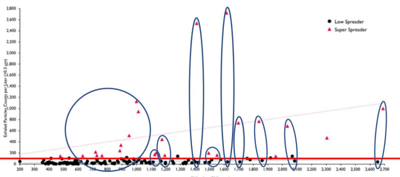

The correlation in the article, while significant, is pretty iffy to me; there appears to be lots of caveats buried in the reasoning. They had a lot of people with BMI*yeara above 1600 that were low spreaders.
TTFN (ta ta for now)
Yes I agree the correlation in figure 2 is not overwhelming. Although it seems to show that superspreaders are rarer and not as super among those with less than 850 bmi-years.
The reason I cited the article was in response to question whether individuals (vs events) can be superspreaders. That is shown somewhat in figure 1A (A is the upper left graph) where you see a very few on the far left emit waay more particles than most people. I think this particular study only looked at respiratory droplets (not viral content) so there may be other viral shedding factors that vary among individuals.

More then iffy.
They say
We qualified as “low spreaders” those 159 individuals who exhaled below 156 particles per liter.
We evaluated relationships between exhaled aerosol particle number and sex, age, and body mass index (BMI). No correlation was found with sex, while significant correlations were observed between exhaled aerosol, age, and BMI—and particularly BMI-years.
They do not show any graf for only age or only BMI.
This BMI-Year graf only contains 146 test persons since the rest haven't left data to be in it.
And if you draw a line at 156 particles per liter.
And then take away every super spreader that has one or more low spreader in the same BMI-year.
There is only one super spreader left at 2300 BMI-year!
Hardly a statistical proven result with 146 test persons.
I would say this is total nonsens.
Or am I missing something?

There was 159 persons that exhaled bellow 156 p/l and 35 super spreaders over, a total of 194 test persons in this study.
The graf contains 146 test persons since they hadn't the right data to make the BMI-year calculation for the rest.
Red triangle = super spreaders = 25 counted
Black dots = low spreaders = 121
There is more people in the graf then 35.
There is no natural correlation between years an BMI to begin with so why make a Unit BMI*years, it does not make sense.

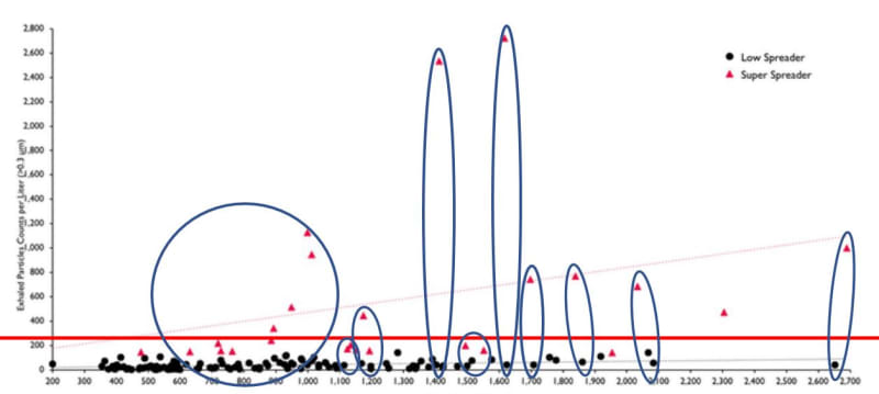

Rather than significant linear correlation, I think what the data shows more clearly is a significant threshhold effect.
If you raise the horizontal red line (minimum threshhold for superspreaders) to about 250 particles/liter, then you can count 12 superspreaders above an 850 bmi-years cutoff and 0 superspreaders below. This is in spite of the fact that about (almost) half the sampled population is below 850 bmi-years. If it were random (probability of superspreader independent of BMI-years), then the probability of a superspreader falling above 850 would be the same as the probability of falling below (0.5). So the probability that 12 just happened to all fall on the right side (similar to flipping heads 12 times in a row) is 1/2^12 ~ 0.00024 or double that for two-tailed distribution 0.0005. So I think there is something there. My analysis would not pass the world of hypothesis testing (even if there were half below 850, which there aren't quite) where you have to define the criteria before you look at the data (I picked the horizontal and vertical threshholds only after looking at the data) so if I were to claim p=0.0005 for the hypothesis that that superspreaders (defined by a 250 threshhold) are more likely above 850 than below, that would not be a legitimate claim (maybe they'd call me a "p-hacker", or worse). Nevertheless it seems a very noticeable threshhold pattern to me.

Does not help every super spreader above the line can be taken out with one or more below in the same BMI-year.

Yes, that's the horizontal line I wanted (thanks).
What they're trying to show are the characteristics of superspreaders. They are not particularly trying to characterize the entire population.
If I draw a random person from the general population, what is the probability that he is a respiratory-particle superspreader? We can answer that question better if we know the BMI-YRS. In particular the aspect I mentioned was:
P(Superspreader | BMI-YRS > 850) >> P(Superspreader | BMI-YRS < 850)
I agree with you the original wording in the article seems off especially talking about (linear) correlation
(2B)+(2B)' ?
There are two regression lines one for superspreaders and one for lowspreaders. What can be said is that if the two top superspreaders weren't there, there wouldn't be much of a correlation for them
