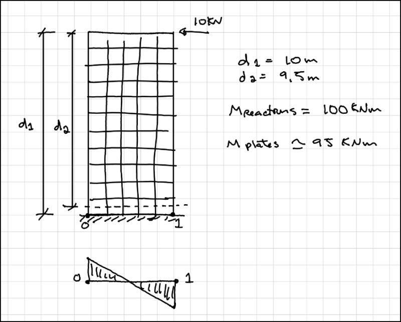

@rb1957 I've been practicing for about 10 years. I ran into this issue trying to integrate axial membrane loads at the bottom of a shear wall made of plates. When integrating at the "bottom" of the wall, that is, right next to the supports, and multiplying by the lever arm, I'm getting 2-5% less moment than Id expect. If I do the same for the reactions, I get the right moment. That's what is driving me back to basics.

one source of your force discrepancy likely stems from the fact that the integrals are evaluated numerically at gauss points within the element and then interpolated/extrapolated out to the nodes/interior polling stations, so the most accurate (but still approximate) stress values occur at the gauss points within the element.
@Celt83 I'm not sure I understand how the Gauss points relate to all of this yet (where are gauss points in the original pages that I posted? Is it complexity that is brushed over?), but this makes sense with the results that I'm seeing. If I consider the lever arm for the moment to be from the top of the shear wall to the half way point of my first plate, it seems to work out. I added a sketch to illustrate what I mean. I can sort of validate this hypothesis by making the first plate very small in the Y direction: it works, the moment at the base goes up.
You should read the manual of the computer program you use. There, or in the graphical user interface, the source of internal forces (Gauss point values, nodal values, nodal average from adjacent Gauss points, mid-element or elsewhere) should be given, and based on that, you can determine the cause of discrepancy.
Have you tried refining the mesh and tracking the change in results? Also, note that shell elements have in-plane shear force (Nxy) and transverse normal force (Nx) which contribute to axial stiffness and force (the effect should be noticeable near the clamped boundary condition), which I assume you did not account for in your hand-calculation. That, as well as averaging/smoothing/mid-element values can easily explain the 2-5% difference.
