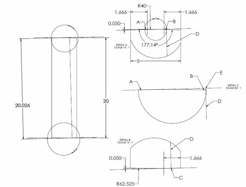

pylfrm 29 Mar 19 00:23 said:
I disagree. That is the unique envelope of minimum width, so rocking would not be possible without an expansion of the envelope. Earlier examples behaved differently due to greater curvature of the surfaces.
This is another point I wanted to address and I finally got to it now - according to my check, rocking of +-1° of the envelope planes around the two radii on the opposed faces would produce an increase of the envelope by as little as 0.013mm (from 20 to 20.013). So from a purely theoretical aspect, your assertion is correct - it is impossible for the envelope to rock without enlarging, but practically I doubt the ability to determine an envelope that behaves this way repeatably.
If we were to simulate a datum center plane from this feature, if I may return for a minute to the notorious requirement in para. 4.11.4 for the undefined "maximum possible contact", then despite the lack of a definition, it is obvious that the envelope of size 20.026 makes more contact with the feature than the 20 envelope. So, which would be the more valid UAME envelope for a primary datum center plane simulation?
Should we ignore a requirement specified in the standard just because it uses a term not defined well enough?
Edit: the subject of this post is the figure posted by chez311 at 27 Mar 19 15:22.
Is it really?
Imagine we measure a bunch of points on this feature with a CMM (with some small random measurement error), and then find the minimum-width envelope of those points (in 2D). Perhaps 19.999 is the result. This envelope will contact two measured points from one surface, and one measured point from the other surface.
Now imagine we rotate the envelope through a range of approximately +/- 5 degrees from the minimum width. We'll have a close approximation to the theoretical 20.026 envelope at somewhere around 1.43 degrees of rotation. Over the entire 10 degree range, the envelope will almost always contact only two measured points. Occasionally it will contact three points, but not more.

See my figure below. While I also think that a convex surface like this with small amount of form error will have issues with repeatably physically simulating that minimum 20 boundary, I do not think that the additional requirement for contact which you have stipulated (resulting in the 20.026 boundary) imparts any increase in stability. So long as we are discussing the physical realities of inspection/simulation - as your boundary rotates, in addition to increasing in size as pylfrm mentioned (however infinitesimally), the line which is normal to the planar boundary on each side (this envelope being tangent to the convex feature surface) increases in separation from the contact points of the boundary on the opposing side. This is represented in my figure by line D, intersecting with the convex surface (of R62.525) and the planar boundary at point C, which intersects with the opposing boundary at point E. Since the closest contact point on the opposing surface is at point A, I would think that the part/boundary would want to pivot around this point towards the minimum envelope as the boundary contracts since the physical reality would be that the simulator would exert a force on the surface creating a moment about this point.
That being said, I do agree that there would be issues with repeatably simulating the theoretical minimum of 20, as there might be with any convex feature - hence the need for a stabilization procedure through the candidate datum concept. In reality I think I would expect the result to be somewhere between 20.026 and 20, the point being though that the "increased" contact at 20.026 does not in my opinion result in any more stable an envelope (or make it any easier for the operator to find the elusive point of "maximum contact") and during simulation I think you would find that the resulting simulated envelope would be biased toward the minimum 20 envelope.
Finally, I rechecked the figure after pylfrm's notes about candidate datums/tangent planes and it just so happens that the points A and B where the planar portions of the upper surface meets the convex portion lie within 1/3 of the width from either end of the feature. Unless I am missing some nuance of the concept, I do not believe the boundary on either side of the 20.026 envelope would be valid tangent planes.
pylfrm, If we are talking 2D,
The 20 (or 19.999) envelope should contact one point at one side and one point at the opposite side - those are the apexes of the two radii in chez311's figure.
At 1.43° of rotation, as you say, is the approximate 20.026 envelope where theoretically the top plane of the simulator lies flat on the flat section of the top face. In practice, this is equivalent to 2 contact points at 2D.
In 3D, I don't think it would be hard to find an orientation where the top plane contacts the flat section of the top face at 3 points. Then the other plane parallel to it will contact the bottom arc-shaped face at 1 point. For the approximate 20 envelope, this amount of contact is not guaranteed.
chez311, that is true for physical gauging simulation, and for physical gauging, both envelopes would have stability issues (the 20 as you agreed, and the 20.026 as you just rightfully pointed out).
If the simulation is done with CMM and an appropriate computer program, there's a substantial possibility to find an orientation that conforms to the "maximum possible contact"/"contact on the high points"/"tangent plane" (choose the least-worse wording) condition at one of the 2 orientations corresponding to the approximate 20.026 envelope, because this is where a plane contacts a more or less flat portion of a surface. This still doesn't lead to a single solution as there are going to be 2 of them, but it doesn't ignore the required amount of contact implied by the definitions in the standard.
In addition, I am not sure that the candidate datum set concept must be applied in this case. It probably must be for physical simulation - with that I agree.

I don't think I ever said the minimum 20 envelope had stability issues - I said I agreed it may be difficult to simulate repeatably. I would say it is the most stable envelope that could be derived from the feature as shown.
This would be true of smooth curves, but not sets of points like I described. If you have an envelope with one contact point on each boundary and those points are directly opposed, then rotation in either direction will allow the envelope width to decrease. If the two contact points are slightly offset, then rotation in whichever direction increases that offset will allow the envelope width to decrease further.
Yes, just like we had with the 19.999 envelope. The points might be farther apart, but the count is the same.
Essentially the same arguments apply in 3D. The minimum-width envelope will have four total contact points (3+1 or 2+2), and an envelope oriented differently won't have any more than that.

pylfrm, intuitively it seems that the more or less flat portion of the surface is more likely to allow tangent plane or "maximum possible contact" simulation, but perhaps you are right. Anyway, I agree with you and chez311 that the definition in Y14.5 for the required amount of contact between the feature and the simulator during UAME simulation is missing, or vague at best.
I suppose that the foregone conclusion from this discussion is that offset-opposed surfaces are better not to be treated as features of size.
