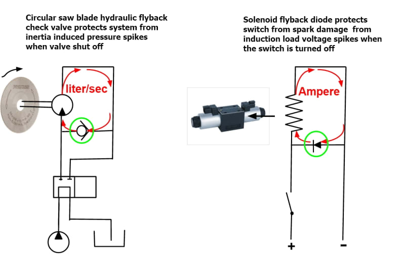

A somewhat fair analogy between an electric DC system and a hydraulic system only work with a hydraulic CP (Constant Pressure) system with an accumulator. Constant voltage alternator=constant pressure hydraulic pump and battery=accumulator. It has to be a constant pressure system and a DC constant voltage vehicle system (alternator and battery) if you want the make a fair analogy between the two.
This is one of my favorite electric vs hydraulic analogies...
