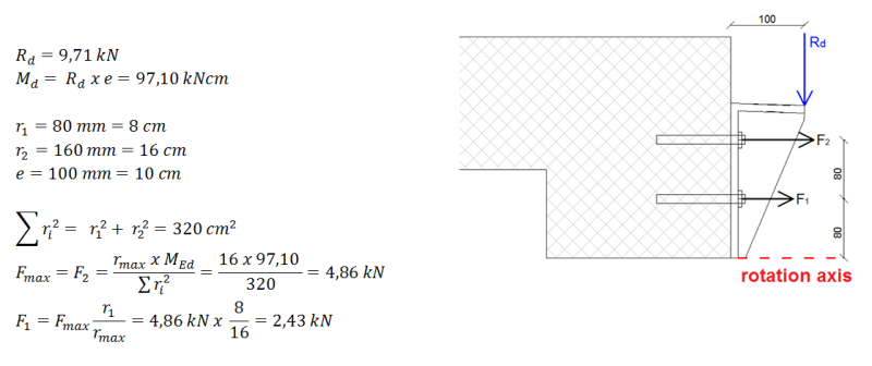

I have to fix a steel console into existing RC beam. Console is supporting a steel canopy beam.
Since RC beam is 250/300 mm I m very limited about how to destribute anchors. I have to consider minimum edge spacing from the edge of concrete and between anchors. So I came up with this:
Normally Id use more than single line of anchors, but in this case forces are small so I think it is OK. Calculations shows that 2 anchors are more than sufficient bu I still feel somewhat uneasy because I have only a single line of anchors. Id add another line but since RC beam is only 300 mm high, I have a problem with steel beam since it shouldnt be too high above the RC beam.

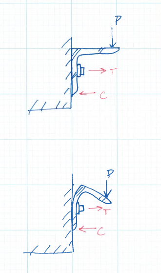

TMH, I don't believe there is any prying action here.
Your sketch implies there is a tension load away from the anchored surface originating between the bolts, but there is none. The tension load is directly at the bolts as a result of the eccentric load.
The deformation shown in your mini-sketch (on the bottom right) cannot occur. The only deformation that can occur is the leg of the angle bending just below the joint between the two legs. If anything the bending in the vertical leg of the angle (especially if the stiffener was not there) would force the steel between the two bolts into the concrete surface, not away from it.
See below. I've removed the stiffener to make it more clear.
I would argue that your sketch is the perfect example of prying action.

There is a difference between the tension reaction caused by this scenario and how AISC defines "prying action". While the sketched scenario is "prying" on the bolts, it's not "prying action" as defined by AISC.
"Prying action" is a secondary tension effect cause by plate bending due to a tension load applied directly to the plate element eccentric from a line parallel to and at the centerline of a bolt. See Chapter 9 in the AISC Manual. The scenario we are discussing does not have this tension load and can't have "prying action".
Fair enough. However I assume the people here indicating prying are thinking of your sketch.
DETstru, I would argue that because the stem is there that it provides a stiff path for a tensile stress component from the flexure of the stem. This tensile stress can cause the typical prying. Obviously there should be some kind of "two-way" action with the compressive stress at the base of the stem but if the plate is thin enough I could definitely see prying action occurring.
I fully agree that the unstiffened angle that you show doesn't receive any prying action, unless the plate was so flexible that it's actually prying the nut itself (but this would have to be a very large deformation I would imagine).
American Concrete Industries
jayrod said:
I would argue that your sketch is the perfect example of prying action...I assume the people here indicating prying are thinking of your sketch.
I agree. Couldn't have drawn it better myself. In my experience, this is the version of prying action that most folks are concerned with in these situations. The center of compression reaction migrates away from the toe of the angle in a manner that is difficult to predict. This is the version of prying for which I like the stiffener.
TME's version of prying is also legitimate when the stiffnener is in play although I doubt much would come of it for most conventional geometries.
So you've got two kinds of prying potentially. And neither is textbook AISC prying so they're rather difficult to assess. All good reasons to try to detail the issue away as has been suggested several times above.

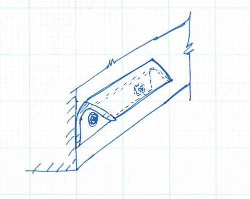

TMH,
The horizontal leg of the angle will prevent any meaningful bending that could create "prying action". This situation is similar to the "thick" plates defined in AISC design guide 4 that allow you to ignore "prying action". Once the connecting element is stiff enough, horizontal "prying action" can be ignored.
That's why WT's used to bolt members with tension loads are such a problem, no horizontal leg to stiffen the plate.
Koot,
For the same stiffness reason above, I don't think there is any meaningful two way action. Just the tension load generated from the T/C lever.

I have read through this thread several times now. TNX everyone for contribution/replies.
What I still dont understand is: why is there so much talking about value e - distance from beam action on angle to edge of the RC beam? As far as I know If I choose larger value of e, the larger eccentricity is which means larger moment and larger tension forces in bolts... So why so much talk about e being closer to the RC beam? e being larger means being more conservative - being on the safe side right?
I use e as a distance between half of a contact surface between a steel beam and steel angle and edge of RC beam
Oh, I was suggesting to use an e at the end of the bracket to be conservative but and e to the middle of the bearing surface would also be reasonable. You are correct that a smaller eccentricity is less conservative.
With the stiffener in there, I favour at least a triangular distribution increasing away from the heel. Point load at the end probably isn't too far off reality.
Thanks for replies. I agree.
I want to ask another question in a case of 2 lines of bolts as shown below.
What is your opinion about lever arm r1 = 80 mm and r2 =80 + 80 = 160 mm.
Would you consider rotation at the bottom of RC beam or higher? What if there was no stiffener but just an angle? would you consider the same? I think it all depends on plate thickness of steel angle.
I think that's fairly rational with one exception: you keep showing the point of rotation as being at the very bottom of the bracket. I feel that there needs to be some acknowledgement of the fact that the compressive stress block against the beam takes up some finite amount of space which will reduce your effective lever arm.
For small scale applications like this, I'll assume the point of rotation (neutral axis) to be right at the upper anchor with a triangular compression stress block projecting downwards. That's a physical impossibility, of course, but I feel that it's nicely conservative and it takes me five minutes. In that case, I'll either ignore the lower anchors or assume that they only participate in shear.
