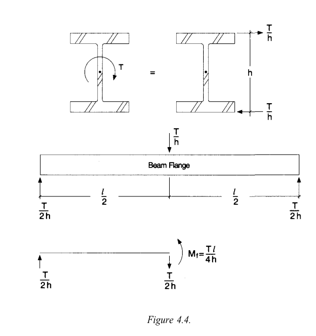

4) Now, AISC design guide 9 does have some better suggestions. For code checking a wide flange member vs torsion (by hand) there is the "equivalent tee" method. Where you convert the torsion into a weak axis bending moment in an equivalent tee cut from the wide flange.
That is good for doing hand calcs and getting an idea of what sort of warping stresses will develop in a member. You can then convert these stresses into an equivalent weak axis moment that would produce that stress on the original wide flange member. Then increase whatever your original weak axis moment was by this amount and use regular H1.1 code equations to check the member. This (IMHO) is way more rational than whatever H3.3 is doing. Granted, you also have to include torsional shear stresses in your shear code checks.

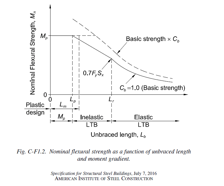

So you agree with the LTB equation in the inelastic range that i posted, which will linearly interpolate between My and 0.7FySx(start of elastic buckling)
Yes, those equations seem reasonable for the inelastic range. They're based on the assumption that the web is slender (which it's not) and that will prevent the member from reaching stresses above Fy. So, that would seem to agree nicely with the restrictions of H3.3.

So, you're essentially saying design for flexure according to the spec (plastic and all) and then make sure your resistance doesn't surpass My (first yield)
I always figured they meant to interpolate from My to the 0.7My for the inelastic range
What do you think of section F5 of the code? (For plate girders and mono-symmetric beams)(You can conservatively use this rather than section F4)
They keep this section totally elastic, and you'll notice in F5-3 they interpolate between My and 0.7My for the inelastic range.

I was referring to the author's of the A360-16 spec.
Here, look at this snip. You're probably familiar with it.
