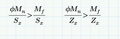

I disagree with that step on two fronts:
1) It's logically inconsistent to calculate an LTB capacity using plastic principles and then prorate it with an elastic section modulus. Again with the apples and oranges.
2) It overestimates capacity. Since Zx > Sx, dividing by Sx will actually inflate the critical buckling stress in a way that is inappropriate.
So I think that I've gotten myself right with that bit of it. I believe that the key to it is to realize what must happen when you eventually compare the "buckling stress" to something as shown below. Whether you take the path on the left or the path on the right, it cancels out to being just the moment capacity. So, as long as one is consistent, the choice of Sx or Zx makes no difference. And, given that the idea is to do everything else in terms of Sx, sure, why not do this in terms of Sx too?
The whole concept of a "buckling stress" is really a bit misleading. In terms of simplified, code bifurcation buckling checks, the parameter of interest is stiffness and not stress. We've only jury rigged the equation in terms of stress in the past so as to make the whole thing more comfortable for folks used to working with rudimentary, mechanics of materials stress equations. Obviously, one can say that a thing buckles at a particular stress but that's a derived parameter, not a fundamental one. I'd be thrilled to see this step in DG09 skipped altogether and just left at Mn.
