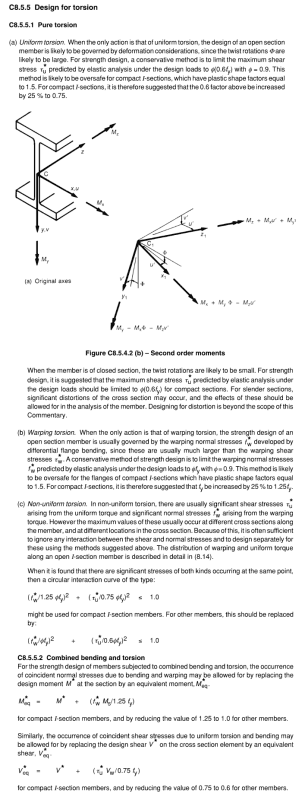

Just to throw another non AISC code perspective into the mix. The following is from NZS3404, it takes quite a different approach to the interaction of torsion/warping and moment than the purely linear interaction equations which have been predominantly discussed above. This is possibly in recognition of some plasticity actually being acceptable (i.e. flange tips) and the fact that maximum stresses are not always coincidental across a cross-section which is important to recognise if you are truly after the 'elastic' stresses throughout the entire cross-section. Most ultimate limit state 'plastic' based derivations of combined actions do not do this, they accept some level of plasticity on the basis that stability of the cross section is still maintained. So they are not really suited to fudging to ensure every point in the cross section has a stress less than the yield stress. These formulations accept some plasticity and redistribution of stresses to result in more efficient design capacities being achieved under ultimate loads.
Secondly, if you are trying to keep it all elastic, what would be wrong with looking at the principle stresses from a fundamental first principles analysis approach. You know all of the design actions (presumably), axial, torsion, shear & moment about both cross-section axes, so just look at the 3D stress state. Obviously, you need to find where it is critical, but that's just running sufficient locations until you understand what contributes to the critical stress state and compare that the strength reduction factor times f_y. Something like this is free and would enable you to automate the process under any combination of loads to give you some insight to where you sit on the spectrum of elastic stresses (or plasticity).
