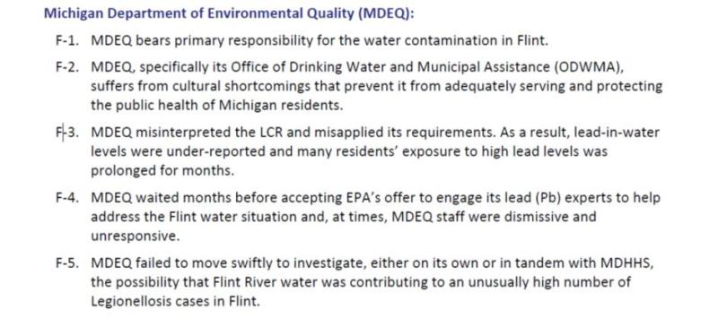

The state of Michigan is "fundamentally accountable" for Flint's lead-contaminated water crisis because of decisions made by its environmental regulators and state-appointed emergency managers who controlled the city, an investigatory task force concluded Wednesday (3/23/16) in a withering report.
Oh, look at this little gem:
"There were failures on all levels of government, including the U.S. Environmental Protection Agency, a report from the task force said"
Leaving out portions of the text is called quoting out of context isn't it? The practice of quoting out of context (sometimes referred to as "contextomy" and quote mining), is an informal fallacy and a type of false attribution in which a passage is removed from its surrounding matter in such a way as to distort its intended meaning.
Here is the entire paragraph:
"There were failures on all levels of government, including the U.S. Environmental Protection Agency, a report from the task force said. However, the report highlighted failures of state agencies, especially the Michigan Department of Environmental Quality (MDEQ), and said the state was "fundamentally accountable" for what happened."
Finding #1 from the actual report says it all:
MDEQ bears primary responsibility for the water contamination in Flint.

You're celebrating a report that states the the argument I've made continually from the start of this thread is accurate, and that your perception is wrong.. Thank you.
Regarding "I would have thought the city water department would be have the primary responsibility.
Looks like it cost three jobs at MDEQ and one at the EPA so far."
The City of Flint was also excoriated. See Page 44 of the report.
However, the MDEQ is also responsible for oversight of Flint. Example: Flint is required to have an water treatment plant operator certified by MDEQ and Flint did not.
"The DEQ has primary enforcement authority in Michigan for the Federal Safe Drinking Water Act under the legislative authority of the Michigan Safe Drinking Water Act. As such, the division has regulatory oversight for all public water supplies, including approximately 1,500 community water supplies and 10,000 noncommunity water supplies. The program regulates the water well drilling industry. Michigan has nearly (1.12 million) households served by private wells, with approximately 15,000 domestic wells drilled each year. The DEQ also investigates drinking water well contamination, and oversees remedial activities at sites of groundwater contamination affecting drinking water wells."

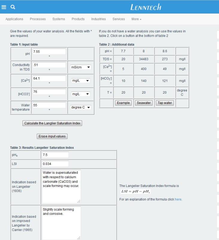

I would like an answer about the pH as well. If this were my swimming pool, I would consider those readings perfect. But I don't know about the pH which should come from the water plant.
The Langelier Index is an approximate indicator of the degree of saturation of calcium carbonate in water. It is calculated using the pH, alkalinity, calcium concentration, total dissolved solids, and water temperature of a water sample collected at the tap.
Basically, the Langelier Index will tell you whether the water is corrosive or scaling. You want a water that is scale forming and non corrosive
Here is an online calculator:
For June 5, 2015 from the operators data, page 5 for tap water:
Results: Slightly scale forming and corrosive.
On June 5, the pH should have been at least 8.3 units instead of 7.55
Plug some of the numbers from the operator's data into the calculator and prove it yourself. In a few minutes, you can see that the operator did not know what he was doing. The operator is mistakenly lowering the pH to a corrosive pH after the lime softening process where a higher pH is used to precipitate the hardness.
