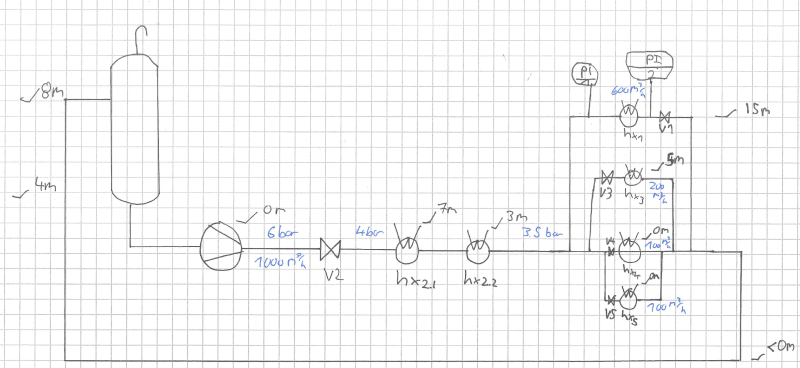

Hello,
we have the following problem: A heat exchanger (15 m) is fed by a pump (0 m). It is a pipe network where other heat exchangers on parallel pipes are located much lower. The pressure gauges read low to negative pressures right before and behind the heat exchanger. Throttling behind the heat exchanger seems to solve the problem. It is suspected that the flow stalls after the heighest point of that branch of the piping system. Nonetheless the flow rate through that branch is higher than through the branch that contains the other heat exchangers, located lower.
1) Can anyone direct me to literature or suitable key words for google, to get more information on the problem of the flow stalling? We suspected because the flow experiences a free fall and accelerates the vacuum in the heat exchanger is created.
2) Another mitigation which was thought of: install a throttling valve behind the pump before the pipes branches in order to increase the pressure. The increased pressure should make sure that the 15 m heat exchanger is supplied with medium. My questions here are:
2.a) The pump head matches the pressure losses of the pipe network. If I install a throttling valve the pressure will rise, but only before the valve. The increase in pressure should match the pressure drop across the valve. So in my opinion it is not possible to control the pressure in the pipe network with this method.
2.b) I am correct in assessing that the pressure at branching point does need to be greather than 15 m + pressure losses across the pipe + pressure loss across the heat exchanger. I suspect this does not pose a problem as long as the pressure loss across the other path is high enough. This would lead me to think we can ensure proper operation by throttling in the branch where the 15 m heat exchanger is NOT located.
Basically I'm trying to determine at which points we can try to control the flow in a manner, where we have no negative presssure at 15 m.
I'd appreciate your input on the situation,
have a nice weekend!

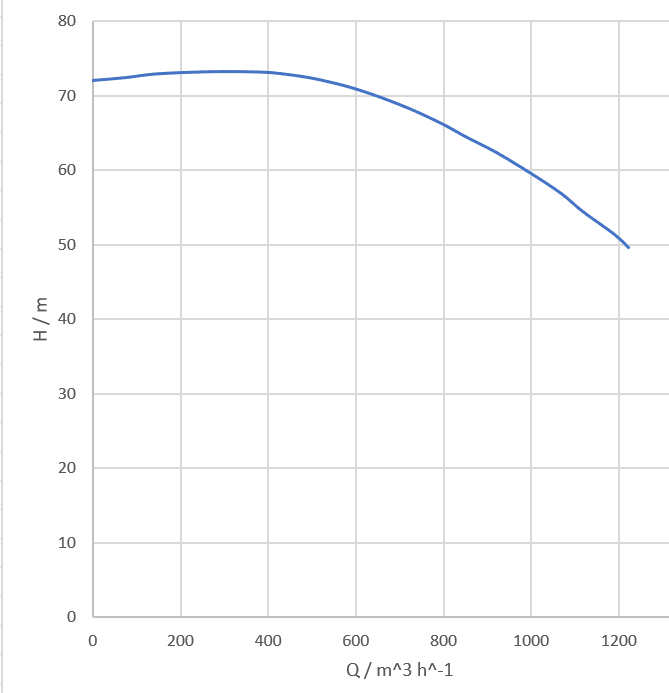

Your questions
Pump curve
Code:
0	72
72	72
139	73
217	73
294	73
362	73
421	73
511	72
607	71
710	69
793	66
852	64
934	62
1056	57
1117	54
1189	51
1222	50
Unfortunately I couldn't find much information on the heat exchangers for now. I did find out that hx1 is designed to work at 250 m^3 / h.
The control valve we were looking at should be a FCV (again, completely unsuited to achieve any pressure control other than maintaining the 4 bar). cv value is 1500 m^3 / h and DN250.
Pipe diameter is DN500 everywhere except the branches are DN200. There should be a little part after hx3-hx5 merge that is DN350 before it goes back to DN500 again. 5 m d/s of the pump is currently DN300 and it is thought of changing it to DN250 if the new V2 valve should be aquired.
The length of the common return leg is at approx. 150 m (this is the distance from the estimated union point and the pump, measured directly from an aerial image + some buffer). So I'd estimate maybe 200 m for the discharge side of the pump until union. It does not help that the return leg is underground and I don't have an isometry. Due to the age of the plant it's not unlikely that I won't get an isometry either. I talked to some people who were also looking for an isometry at some point in the past years and didn't find any, too.

Now that we see that there is no heat exchanger in the common return line I am even more convinced that a simple vent at the high point is the answer. As I said before, the fact that the pressure gauge between Hx1 and V1 indicated a vacuum tells me that if this pressure is increased to 0 gauge the situation can only improve.
In case anyone thinks I am making all this stuff up, have a look at page 205 in the article by Larry L Simpson in the June 17, 1968 edition of Chemical Engineering. I didn't invent this technique - it was well known a long time ago and I just implemented it a couple of times.
With regard to your latest Question #1 - the downleg from the point A to the 8m level should be made self venting. Below the 8m level it will remain flooded with liquid and does not need to be self venting. The vent pipe can be much smaller. Probably 100 mm NB is plenty big enough.
There needs to be a valve in each heat exchanger branch for flow balancing purposes - and it appears that this is already the case. Setting the valves manually is a trial and error process because adjusting any one of the valves influences the flow in all the other branches as well. Automatic flow control through each of the branches would be great, but expensive.
The drop from Hx3 down to the common point will remain flooded because the inlet to the tank is at 8m. There will not be any vacuum created in the outlet from Hx3.
In response to the most recent post by 1503-44, there is no danger of air from the vent being trapped at high points in the return piping if the downleg from point A is designed to be self venting. The vent is not just an additional complication. It is the central piece in the solution. Without it there will always be pulsations and/or vibrations.

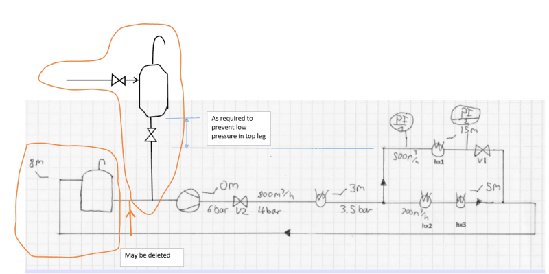

Below mark-up was my suggestion. We follow this type of system religiously for power plants. I hope you will not have any contradicting esoteric process requirements in your plant

What purpose does the original tank then serve?
You can't make water flow up hill.
All you're doing is turning an open system into a closed system.

Don't think you understand. Your concept creates a (15 + 2) meter long vertical gravity standpipe with a gravity drain back to the tank. The reason that it will work is that you have created separate return legs. Agree that it will work but the standpipe has to be high enough so that it doesn't overflow.
Since it is now an open to the atmosphere cooling system, the owner would also have to institute a chemical treatment program to control organics and corrosion.
Folks, the system is already open at the tank. If they do not have a chemical treatment program already, they should have.

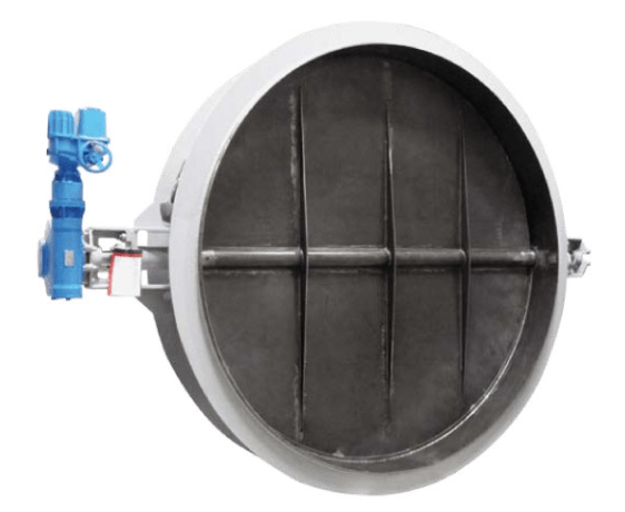

"V2 right now is just a flap" I'm not sure what that means. Is it a one-way flow, "check" valve?
There is also a check valve in place (omitted in the sketch) but I mean that V2 is currently of this type:
This is what I meant by flap.

Your "flap" valve is normally called a butterfly valve. Flap could be misunderstood as a non return valve.

The existing return is a pressurized pipe:
1. If the air is removed through venting;
2. If operating with enough flow velocity to push the air out and back to the atmospheric tank.
Adding the vent at the top changes the operating scheme to a pressurized pipe to the upper heat exchanger and then it is a gravity flow return pipe downward to the atmospheric tank.
The scheme suggested by katmar has more or less created a flow scheme with separate legs (into the gravity return standpipe).
You will need some type of chemical treatment. Otherwise, the heat exchangers may foul and you will also have MIC.
How is the heat energy being removed from this system.
One of those inline HXs I believe
It seems that the pump can get some flow to V1, but at the outlet pressure is less than 1 barA.
Without the vent, assume partial flow in the pipe at V1's outlet and say you only have vapor pressure, or something less than atmospheric. That pressure is driving the downstream leg flow back to the tank. Now drill a hole in the pipe and pressure increases to 1 barA and then you get more flow through the downstream leg. Or in other words, that vacuum pressure is no longer trying to suck liquid from the tank back to V1. Since you now have 1 barA at V1 and 1barA at the tank, gravity balances the downstream segment. Add a meter height of water into that segment from V1 and a meter at the other end is forced out into the tank. There is an additional friction loss there, if you do it fast
