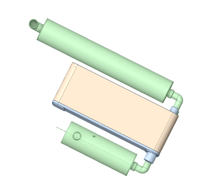

Hello,
We are developing a heat recovery device for domestic hot water (grey water not black water).
The heat exchanger is made of 304 steel.
At the moment, we use PVC connections to the 2 inlets / 2 outlets to ensure there is no contact with copper or brass fittings.
I would like to change some of these to steel parts. They can be 303, 304 or 316 steel.
The reason for the PVC connectors connected to the heat exchanger is to prevent galvanic corrosion.
Is there any risk of galvanic corrosion if we connect this flexible steel tube directly to the heat exchanger: (I work for a French start up - your browser should translate).
Other fittings I have seen contain 316 or 316L steel. Would these be suitable?
Does the L (Low Carbon) change the risk of experiencing galvanic corrosion?

i should give details of how the system has evolved as this will affect the answer
connected the heat exchanger are 2 tanks - both made of SS304 steel like the heat exchanger. connecting the tanks to the heat exchanger are two SS304 female G1/2" elbows with free nuts
I want to know the risks of connecting the nickel plated brass connectors to the ports of both the SS304 tanks
thank-you

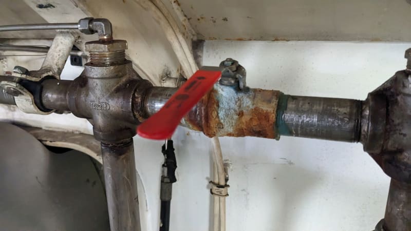

The heat exchanger you have selected will not tolerate your intended service. It is meant for non-corrosive service with clean and treated water. Address this issue before worrying about your fittings.
Otherwise, a brass and stainless pairing is subject to dezincification. Here is a brass valve installed in some stainless steel saltwater piping on one of my boats.

TugboatEng - i appreciate your concern. We are building on a system that has been on the marketplace for 10 years and has not had a failed heat exchanger in the same application. We have a backwash system for unblocking. We have the system working on customer sites.
I am trying to develop the next build of the system, and I need help on some of the design choices.
on the side of the system where there is clean water, i need to transition from nickel plated brass to steel at the 2 points that i have mentioned (not directly on the heat exchanger)
as the temp of the system is low (max 40C) we have been successfully gluing PVC G1/2" threaded parts between the steel & brass.
I am trying to ascertain on the clean water side if its necessary to have this dielectric break
