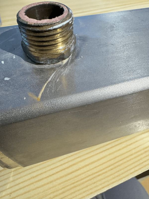

We are developing a heat recovery device for domestic hot water (grey water not black water).
The heat exchanger is made of 304 steel.
At the moment, we use PVC connections to the 2 inlets / 2 outlets to ensure there is no contact with copper or brass fittings.
I would like to change some of these to steel parts. They can be 303, 304 or 316 steel.
The reason for the PVC connectors connected to the heat exchanger is to prevent galvanic corrosion.

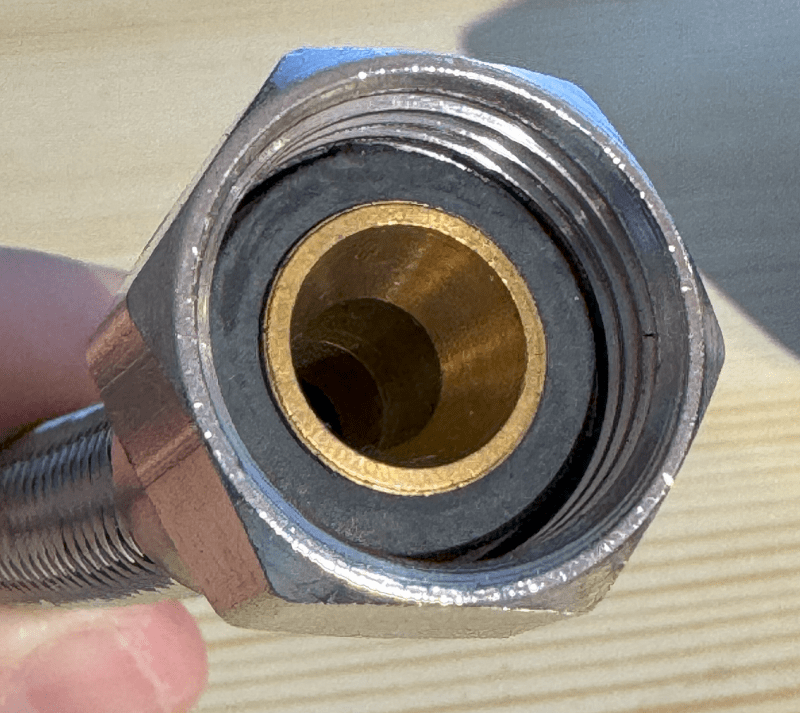

Is there any risk of galvanic corrosion if we connect this flexible steel tube directly to the heat exchanger: (I work for a French start up - your browser should translate).
Other fittings I have seen contain 316 or 316L steel. Would these be suitable?

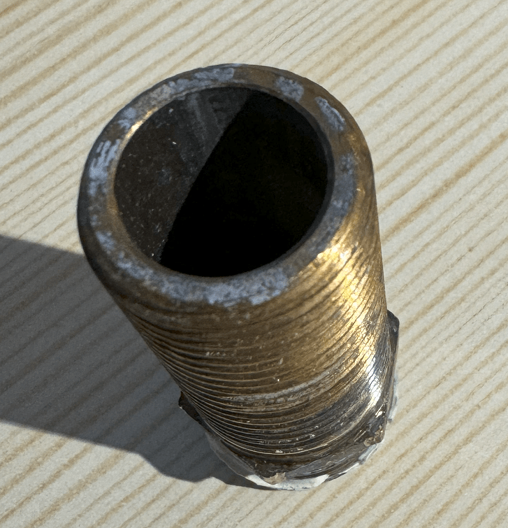

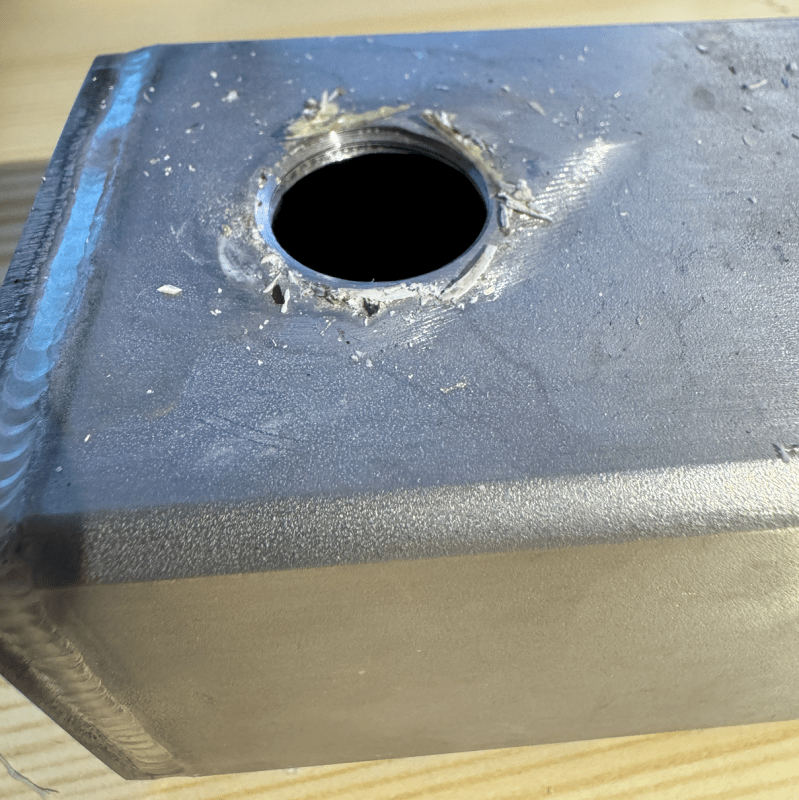

We have a brass threaded G1/2" nipple that is glued into a stainless steel small water tank that has a heating element.
This tank was made before i joined the company so i cannot confirm if it was SS304.
(on the top is what is left of the fibre washer, its not corrosion).
I removed the brass threaded G1/2" nipple.
The white residue is the glue.
There looks to be green marks on the brass.
From what i read this is oxidisation - not galvanic corrosion - is that correct?
This is the end that would have been submerged in water inside the stainless steel water tank.
This water heater has not been used in a long time so it was not full of water so the thread would likely have been wet but also exposed to air.
these marks are not green, more like grey. Do you know what

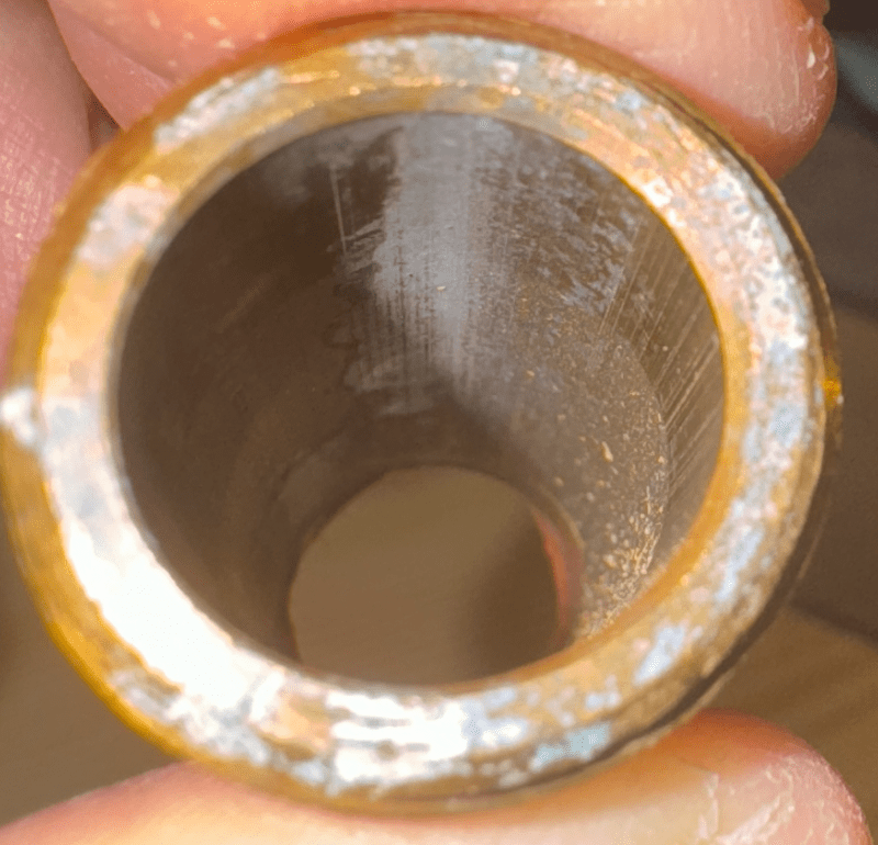

This is a picture of inside the brass connector (taken from the end that was inside the stainless steel water tank
thank-you
Brass is subject to dezincification. That will produce a grey colored oxidation. If you clean it off you'll see red copper left behind.
thank-you for confirming the dezincification.
the water in this section of our system is clean tap water.
is the cause of the dezincification related to dissimilar metals (i am starting to google to understand this).
from the pictures, did you see any sign of galvanic corrosion?
Does nickel plated brass suffer from dezincification?
thank-you
If you scratch at the surface you can compare different areas.
Areas with dezincification will have some a somewhat porous appearance and a more pronounced Cu color.

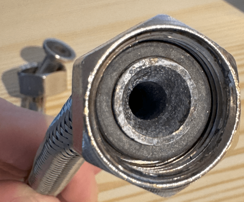

This is a Steel brained EPDM home with brass (and nickel plated brass connectors).
It was used on the grey water side of the system (the water was contaminated with shower soap / shampoo).

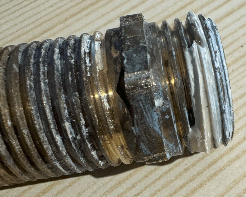

This is a new part:
This is a part that has been used. It was connected to a threaded PVC connector (not a metal connector):
What type of corrosion is this?
