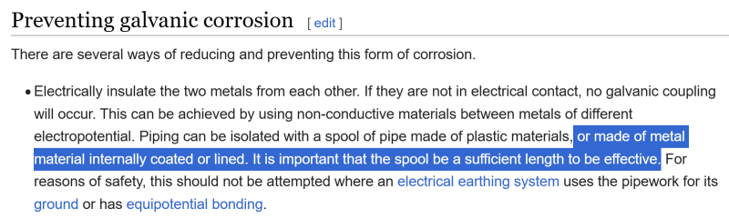

I have just seen this on Wikipedia:
It is suggesting that if a section of metal pipe had a plastic lining, even if there was no break in the electrical connection - it would prevent galvanic corrosion. Have i understood it correctly?
