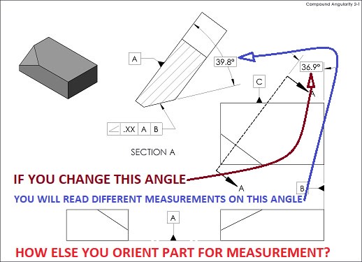

In recent discussion thread1103-442213 we opened Costco-sized can of worms regarding use of orientation controls.
Here is the question I wanted to ask but had a feeling that it would hijack the thread, add confusion to the discussion and not get as much attention as (in my opinion) it deserves.
I would like to collect opinions of members of the community to the problem:
How would you approach the case of angularity applied to surface randomly oriented wrt your coordinate system / DRF as shown on the picture?

Sorry for the late answer. By my experience there are sometimes conpound angles where two angle controls at two separate sections is a beneficial practice.
Perhaps this case can be dealt with utilizing only one control, because the required section cut direction can easily be determined as ahown by CH in his figure with the single section cut.
CH, I don't agree that you can alter the datum precedence order. In your example involving angularity to |A|B| the tolerance zone would not change when you change the datum sequence only for an ideal part. For an as-produced imperfect part the datums and the tolerance zone will not be coincident between the 2 scenarios |A|B| versus |B|A|. Try to model an imperfect part and stabilize it according to each DRF, and define a tolerance zone basically oriented to the datums for each case. You will get two different tolerance zones.

Regarding the second image posted by CheckerHater, "Compound Angularity 2-1":
The dimensioning scheme is perfectly acceptable, and it fully defines the basic orientation of the toleranced surface with respect to the datum features. The scheme suggested by chez311 is acceptable as well, although the same two angles could be equivalently dimensioned using edges in the views already shown. Various other dimensioning schemes would also be acceptable, including ones without any angular dimensions at all. Some of these schemes are certainly more useful than others for building drill jigs.
The angularity tolerance is perfectly valid as well, and the orientation of the tolerance zone is fully constrained with respect to the part. It would be equally valid for the tolerance to reference |A|C|, |B|A|, |B|C|, |C|A|, or |C|B|. If there is no need to fully constrain the orientation of the tolerance zone, then the tolerance could reference |A|, |B|, or |C|. The appropriate choice would depend on the desired result.

A question about your example - if you sample a line element along the angeled angled feature in a direction perpendicular to the direction of the section cut, is that line element nominally parallel to A? If not, perhaps 2 controls are beneficial over one in this case too.
pylfrm,
According to the scheme I proposed the tolerances would apply to the controlled surface (of compound angle), and call out 2 datums according to the part's functional interface. It would look similar to what CH showed, for each control.

All right. Each tolerance would need to use a leader line terminated in a dot within the outline of the surface, and you would need to construct the section views such that the outline of the surface is actually shown.
CheckerHater's section view cutting plane is perpendicular to datum feature A, so a line element perpendicular to the cutting plane would be parallel to datum feature A. Such a line element only exists because the cutting plane is perpendicular to the angled surface as well.
This seems like purely matter of drawing view layout though, so I don't see why it would make any particular tolerance scheme more or less beneficial.
pylfrm
As long as you can always orient the part for measurement to get repeatable angle measurements that represent the angle that should be measured in the drawing view you show, there is no problem with a single angularity control. If not, setting section cuts normal to datums B and C ( and A always), and conrolling the 2 angles that construct the compound angle separately, is a possibiloty possibility to consider.
Sem D220 said:
As long as you can always orient the part for measurement ... there is no problem with a single angularity control
Don't you think that to orient part for measurement you need second angularity control?
I think we might understand the word "orient" differently. According to my understanding: no. You don't need any (one or two) angularity controls in order to orient a part for measurement. You do need to orient a part for measurement in order to verify angularity controls, be it one control or two controls. I'm not nitpicking, I'm just not sure I understand your question, and answer according to my interpretation.
