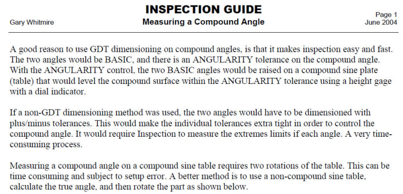

How would you approach the case of angularity applied to surface randomly oriented wrt your coordinate system / DRF as shown on the picture?
CH, your diagram says that the angle of the section cut affects the measurement result for tye angle. It's true, but I still don't see how does that have to do with 2 angularity controls?
I guess we misunderstood each other, one FCF, but 2 angles, 2 datums and acceptable datum sequence.

Just out of curiosity, how are you going to machine this surface?
CH, If you mean the dimensioning scheme shown in SeasonLee's figure, one way is to orient the raw material block at the machine table similary to the way it is depicted on the sine plate and then mill that feature with horizontal tool feed. To orient the part correctly before machining you need to consider the two angles shown - 15°, 25°. I wonder why there are no datums specified at the angularity FCF, though.
But HOW you "consider" TWO angles with ONE sine plate?
If you're still asking about machining - you can utilize the rotary axes of the machine. You need 2 rotations. If it's a simple 3 axes machine you will probably need a fixture mounted on the machine table in which the part will sit oriented like it should 8n in 2 directions.
How to orient: consider the workpiece at the view where you see the 25° angle. Now give it one rotation of 25° counterclockwise, and then a rotation of 15° about an axis parallel to the bottom of surface of the part.
I leave it right here
Just in case you were asking about the sine plate (measurement) - then you can simply follow the instructions in SeasonLee's figure :-)

pylfrm, I agree, and I think that the substitute to that angle should be another angle defined on the angled feature itself. It could be another section cut perpendicular to either B or C (and A), depending on which one of them is functional and should be called out. As it is now, on the angled feature itself, only the true angle is defined, but not the "direction" of that angle. I don't consider specification of the direction of the section cut as a valid definition for the geometry because it only specifies the view, not part geometry. If it's fixed, it may force measurement of an angle that is not really the true angle.
season lee - the math is incorrect.
For side angles A & B the true slope will be greater than either of them. This can be deduced from inspection.
From the common vertex to the top surface is some distance Z. The distance along one face as projected to the bottom face is X and the distance along the other face as projected to the bottom face is Y.
The angle of the first edge to the bottom face is A = ATAN(Z/X). The angle of the second edge to the bottom face is B = ATAN(Z/Y).
Note that the ATAN function returns larger values for larger arguments. Note that the nearest point along the top intersection to the common vertex is closer than the common vertex is to the vertex along X and the vertex along Y - call the segment T, for the perpendicular segment from the common vertex to the top surface edge projected to the bottom face.
For non-zero A and B, T < X and T < Y, then ATAN(Z/T) > ATAN(Z/X) and > ATAN(Z/Y)
My calculation, given 15° and 25°, is a true slope of 28.2718085050179°
Added:
My previous solution was in GeoGebra which also shows the "rotate theta1; rotate theta2" method produces an error of 1.36° in the apparent slope when the claim was that the error would be 0°. However, the overlapping geometry is such that it's easier to have people recreate it on their own than spend time on explaining all the vertices and line segments, et al.
So I re-derived just the true slope calculation from trigonometry, where t1 and t2 are the acute angles along orthogonal sides:
turn angle from side with t1 = arctan(tan(t1)/tan(t2))
trueslope(t1;t2) = arctan(tan(t1)/(sin(arctan(tan(t1)/tan(t2))))))
It is notable that while the trueslope() function fails if t1 or t2 equals 0, for arbitrarily small values of either t1 or t2 the true slope approaches the value of the other; this was also a problem for the GeoGebra sketch - small values of t1 or t2 created geometry that is so large that it made the sketch unintelligible because the intersection approaches an infinite distance from the common vertex. So trueslope(0.0000001°,45°) will result in a value of 45.0..000x°, where an arbitrary number of zeros happens before the first non-zero digit. As demonstrated earlier, the true slope will be larger than either angle.
