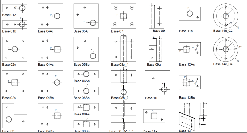

Assuming the post fits on the plate with room for weld + 1/8 added clearance... the force on the two anchors is the moment / 26mm. This is divided by 2 because of the two anchors. This force is resisted by the plate having a moment of (144mm - 0.9 x dia post)/2 - 25mm [adjusted for prying action]. The plastic section is used to calculate the resistance of the plate...
Design the anchors for the tension and their proximity...increase spacing and size as required.
I have SMath programs for the following bases:
06Bc and 06Bs do it for circular and square tubes, respectively. The programs calculate for combined tension and shear, but the shear component is just a fraction of the tension force.

The min width of plate, I use, is the dia of the post, 2 x the weld size + 1/8" to allow for 1/16" outside the weld. I also reduce the post to .9, like I do for columns and my program allows for ASTM A500 HSS reduced dimensions.
I include for shear, but since the shear load is just a small fraction (generally) of the tensile load it almost never comes into play. I also do a check for 10% overload just to draw my attention to the stress conditions.
Thanks pham... a BPS. I'll check and reduce even further. I can see that for circular, but I reduce for both circular and square/rectangular sections. In reality, it's almost a beam
section, and I used the 0.9 thinking it was behaving like a column-flexure in some fashion. Using 0.8 will increase the plate moment a tad (normally doesn't govern).
