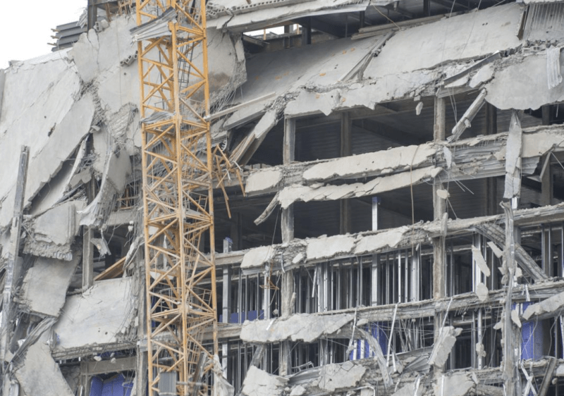

Purely based upon photographs, I think the PT deck (transfer level and those below it) fared considerably better than the structural steel with metal deck-slab.
Lower levels with PT:
Upper level with structural steel + metal deck:

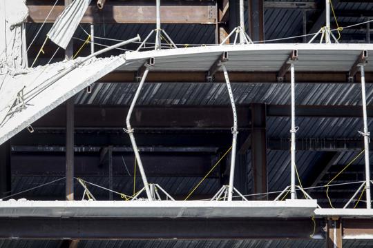

Check out the steel framing and deck orientation in the cantilever...where those small canti tubes supposed to hold the floor up? The shoring appears to fail, but this appears to be some weird, inadequate framing
