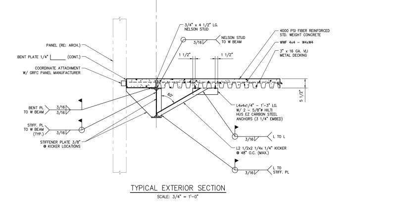

Not sure if those tubes in the picture are actually permanent structure or just shore beams to temporarily support the deck until the concrete reaches strength, perhaps the final intended end condition would match the lowest visible floor in the image posted by structuralengr89. The one flyover video post collapse appeared to show a good bit of reinf. steel in the concrete deck.

Agree those tubes are probably just shoring.
If they were counting on the deck cantilevering over that (rather petite) beam, why would the deck change orientation? Why would such a detail be used to begin with? Maybe those tubes were to connect to part of a (structural?) curtain wall system? I wish we had a higher res picture of the tube-to-beam connections. And looking at how the tube on the column line is still oriented vertically, it seems that the tubes might not have any shear studs?

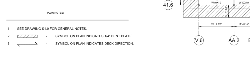

Drawings seem to show a different edge detail:
@Tomfh
There's an alternate floor plan. No details seem to be shown for this floor. Tubes are shown to be final structure.

I though so too, but the Permit structural drawings (S3.5A and B) show:
No backspan, and framed into a W10x19:
Interesting that permit set drawing S3.5B is OPTION B for 16 & 17th floor framing:

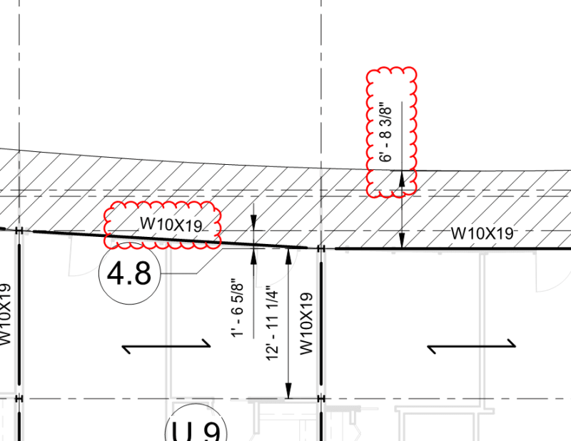

The deck spans in many locations (+/ 25 feet) seem quite excessive for a 3" composite deck (5.5" total slab thickness).
How far does this decking normally span? What sort of span to depth ratio?
So with that HSS outlooker detail you'd be relying on torsion in the beam and tension in the 4x4 WWF to resist the out-of-plane bending moment, correct? I sincerely hope this wasn't the intention.
However, looking at the rendering posted by dold, the cantilever on the 16th/17th level looks to be a balcony exposed to view from below. So the architect probably requested an alternative to the bent plate and gusset detail used on other levels to achieve the envisioned floating look.
Those spans for deck are way excessive, they can't be right but that is what those plans show.

And my Verco catalog cuts the W3/5.5" concrete tables off at a 16'-0" span, although I'm sure maybe a couple more feet (under really light superimposed loadings) could be justified by calculation.
I sure hope these aren't the final drawings. Every floor beam on the 16th and 17th floors is a W10x19 outside of the elevator shafts.
Hopefully the column sizes on the upper levels were increased beyond W6x20s.

Surely that was not the final set. Its marked as a permit set and the project is listed as permit phase on the title block. But from just eyeballing it, the photos seem to reflect the member sizes on the plans. From my load tables the 3" 16ga composite deck caps out at 95 psf at an 18' span. I do not see it supporting a 70 psf load for a 26' span.
Am I reading plans right that one option for the cantilever was a huge plate and stiffeners, that doesn't seem very practical? I imagine the designer was counting on the kick backs shown in the section below to be installed with the tube option as well but there is no detail covering the tube cantilever option that i see. Either way it is a very light section to cantilever off of.

The stamped permit set shows no rebar in slab (4000 psf normal wt with fiber and mesh). No way that the deck guy (or an engineer paying attention) would do that, there has to be an explanation. Maybe you could put enough rebar to make it work on paper but that would be super outside the norm.
