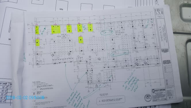

Someone posted the link but deleted it. It's a public website, not behind a login or anything, and these are effectively public records. Look for "HRH_1031_CANAL_STRUCTURAL_FULL_SET_6.8.2018....". These are SEALED permit drawings - nothing on the drawings saying 'not for construction', etc. You'll notice in some of the inspection pictures (see below) it looks like there were at least two revisions, at least to the foundation drawings...

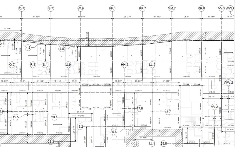

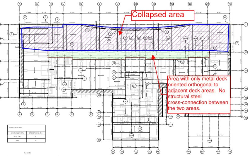

OK - looking at the framing plan there is an oddity in it - not sure if it could be considered a cause, at all, of the collapse.
But running down the length of the building - right at the interface between the remaining structure and the collapsed structure is a long corridor made up only of the deck-slab.
This deck slab is rotated 90 degrees from all the other deck slabs in the building.
What's more, there are NO structural steel beams crossing this long corridor at all.
I would never do this. I always want to connect my steel throughout a frame and not rely on 2 1/2" of WWF reinforced concrete to hold the structure together.
JAE, could that strip of decking have acted as a fuse that prevented the remainder of the building from collapsing?

If the building was essentially perforated down the middle by that strip of decking without framing, that could possibly explain how the collapse seemed to wrap around the front from one end to the other without pulling down the rest of the building with it.
Yes that is most likely true.
The collapsed area JAE highlighted had a series of W16x26 transfer girders at the 15th floor supporting the W6x20 columns above (which support 3 additional levels).
Dold...You get a star for your W10x19 girder comment!
Let's hope those plans you linked which are sealed and do not state NFC are not what was used for construction!!!
These drawings are a mess they have a HSS6x3x3/8" girder supporting a W21x444, grid F and 31 15th level. Along with grid 39 PP to YY
