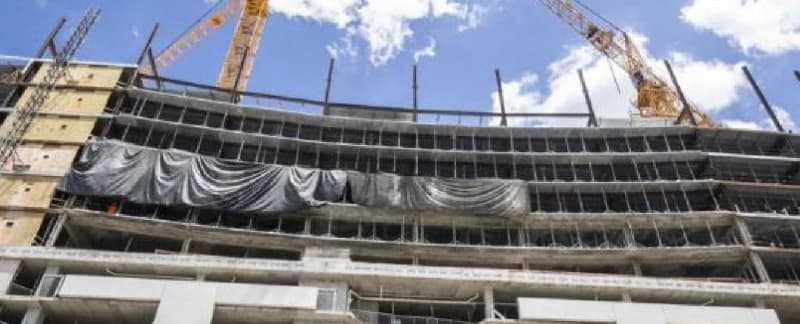

These cantilevers are having a shoring above which seems not loaded on the beams below this might be the case of it might be shifted during the collapse
Also, it is noted that the steel columns in the upper typical floors are shifted from the columns below. This discontinuity could accelerate a progressive collapse.
Lack of shoring is a factor in these systems where the deck is designed to be the form work. The structure seems to be very optimized with light sections at the typical floors that noway it could handled an additional weight on the horizontal or the vertical element (ideally it would not be required to)
If the design is concluded to be done properly a probable cause is the localized failure of floor bay had a domino effect on the others above and below and that one or two bays caused it all.

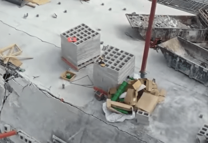

This too loaded at the roof with such a small distance apart not sure how the filled steel deck with the long spans handle these weights
To say nothing of the tubs of debris.

Some pallets of blocks and some garbage bins should not be causing such a large scale progressive collapse.

Check out the steel framing and deck orientation in the cantilever...where those small canti tubes supposed to hold the floor up? The shoring appears to fail, but this appears to be some weird, inadequate framing
I'd have to assume we're seeing incomplete structure here, shoring being a big clue of course. I mean, there is no good load path for those stub cantilever tubes - no back-span, only a small beam in torsion to resist the moment. There must have been some more steel that would eventually be installed to support the ends of the tube steel members...

Do I see that overhang detail correctly? A W-flanged girder with periodic tube sections cantilevering out 6-10 feet without backspans to support a slab on metal deck?
If so, it would seem like a pretty flexible system. Did all the load just keeping going down the most-stiff path (temporary shores) until one finally buckled and set off the dominoes? It probably wouldn't take much for the bottom flange of the W-shaped girder to get "pushed in" when the cantilevers suddenly tried to engage and take the load.

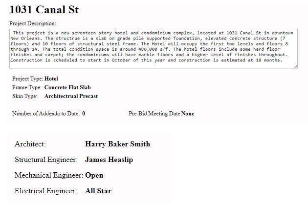

Looking at the contractor's website and the structural engineering firm's website, neither seems to have a project anywhere near this height or scale in their portfolios.

Some generic info displayed on Citadel's website - their plan room access to the drawings isn't active.
Is it typical to offer financial incentives for early completion on a project such as this one?
The structural engineer has a team of 2 engineers, an EIT, and 5 designers. Seems like a project the size of this would warrant a larger team of engineers. If the designers are truly designers and not just CAD people I could see that helping but a 17 story structure would keep an engineer and EIT busy for a significant amount of time.
For the record, this may have nothing to do with the design and might be a construction error. I just found it odd that such a large project had a structural engineer with such a small bench.
