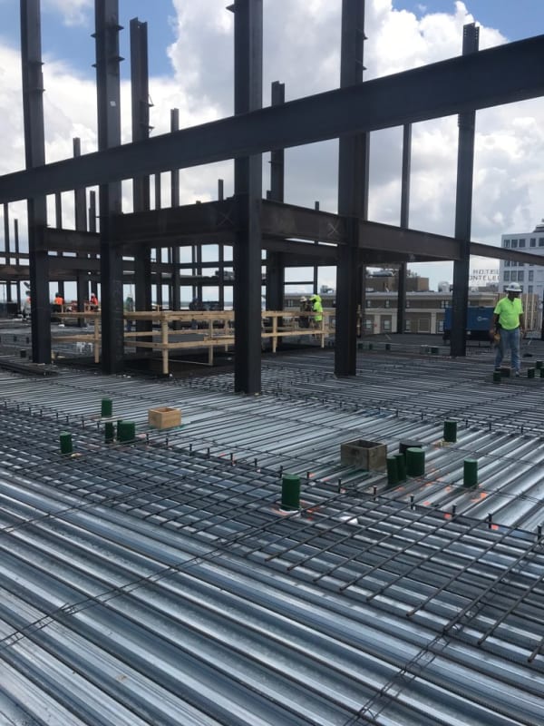

Photos from the NOLA website.
This is an area that collapsed. Deck shows reinforcing.
Reinforcing shown elsewhere too:

Something I noticed from structuralengr89 post of 13 Oct 19 16:59 (showing the photo of the buckled post-shores) immediately above, the W beam connection to the column shows a bolted flange connection BUT the web plate has no bolts installed, and no field weld is visible either.
I wonder if other beam/column connections had similar yet-to-be-installed bolts. The metal deck is already installed at this floor - and it unusual to delay bolt install after deck is installed.
The likely failure mode has to be torsion on those 25' long W10x19 girder, right?
As soon as those temporary shoring posts were removed (or started to buckle), that HSS6 cantilever + W10x19 girder system needed to take up the load from that 7' cantilever edge condition.
