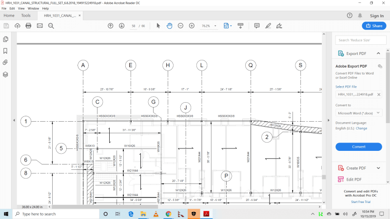

Have we discussed the unusual framing in this portion of the structural drawings from 2018? I hope this was revised in the review process.
And let's not forget that this strange building was the creation of the architect. The structural engineer was simply trying to support the architect's beams and floors against the force of gravity.
In looking at several of the photos on the NOLA site, it appears they used a Versa-Deck dovetail composite deck. If properly reinforced and shored during construction it can span 25+ feet.
This is borderline doxxing by a bunch of junior detectives with limited evidence. Please tread lightly. Peoples lives and livelihoods are at stake.
As JAE has pointed out, the corridor didnt have beams tying the steelwork on either side.
From looking at the layout drawings there are 3 steel braced cores all of which are on 1 side of the corridor, with no cores in the area that collapsed.
Obviously we dont yet know what triggered the collapse, but once something started, the lack of any tying back to a core around the perimeter (other than the metal deck slab) would explain the disproportionate collapse.

JAE pointed out what the point of this thread is earlier and it is absolutely fair that we hold each other accountable as engineers. We will wait to see what the investigation reveals but in reviewing available information - SIGNED AND SEALED PERMIT DRAWINGS - we have found many instances that raise an eyebrow. Many items that make you say "well it probably COULD have been done that way, but should it have been?"
When the bar continuously gets lowered and things are done simply because they can be, even when they shouldn't be, simply to meet unrealistic demands, we all suffer. Who knows if that is the case here, but looking at the available information it sure seems like there were a lot of corners cut. As has been said many times already in the thread, hopefully a revised set exists that cleans up a lot of these concerns...
