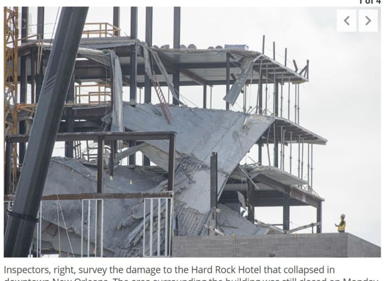

I hope the guy in the yellow vest in the lower right hand corner is getting paid well to stand in that location.
Yeah, he's definitely standing bow-legged

Have a look at this video around 1:00-1:05. Granted, there is now a tremendous load on those columns due to the 2 floors of slab still hanging off the right side. But good heavens look at the deflection of that beam with the two columns on top. Furthermore, observe how the deck on the 14th floor is just totally gutted all the way back to grid 32.
Also tagged up some numbers on the floors. The 'transfer floor' is the 16th floor. Using the elevator frame elevations as reference. Speaking of which, what happened to all the braced frames? I see none in the pics and vids? Nixed in later revision?
Deck rippage:
Floor count:
Transfer 'girder' deflection:
