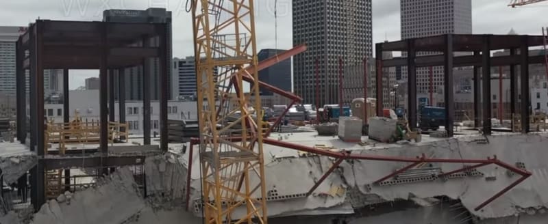

After looking over the plans (which I lost and can’t find now) if I may offer a few observations:
1. The tubes attached to the spandrel beams are structural as demonstrated by the orthogonal deck span that changed directions in the cantilever.
2. The beam supporting the cantilever would be in torsion unless it is tied back by the back span reinforcing.
3. I see no serious back span top steel steel the back span in close ups posted at the failure (such as with the man in the yellow suit)
4. I see that the cantilever steel is in the second layer of steel in the failure area if the steel exists.
5. The effective depth of the cantilever steel, if existent, is about only an inch or so in the failure area which further illustrates the structural nature of the HSS sections.
6. Since the outer slab cannot function as a cantilever, its load would be taken to the cantilever beams, then to the shores.
7. I propose that the shores may not have been removed after pouring each slab, therefore leaving the load in the shore rather than transferring it to HSS sections.
8. The shores finally buckled due to over-load of carrying multiple floors and the collapse proceeded.
9. Could it be that the HSS tubes were to connect to something else at their cantilever end to support them and "make it good" and were to be shored until that time?

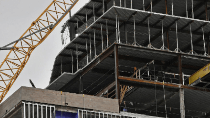

View of the underside of the (load transfer) 16th floor showing framing different than plans submitted with the permit, obviously they had been revised. It would be nice to get a copy of the latest revisions.
Double cantilever in the photo above is interesting. I don't see how it could possibly work at the slab and metal depths assumed. No beam to take the load. Was the bottom steel deck split at a 45 degree angle?

It's hard to tell with the quality of the photo (at least, the quality as it shows up on the webpage, maybe the original is better), but it almost looks like the decking is at a 45 degree angle to the supports in that corner..? It may just be weird shadows.
Can you apply for a code exemption to the effects of torsion in North America?
That double cantilever looks mighty suspicious to me given the beams/girders appear to be I sections. I cannot comprehend how that even works unless the beams were simply there as permanent formwork to support the metal decking and the slab topping thickness did all the business cantilevering over the main beams. Either way it seems like the designer missed something fundamental if the framing that's visible was intended to be the final structure.
I think the designer missed a lot of fundamentals.

Another view of the underside of the (load transfer) 16th floor showing framing
Interesting, GPR Tech's picture shows the cantilever holding up without shoring. I saw in some earlier pictures what appeared to be rebar in the slab. I wonder if the intention was for the concrete to act as a cantilever? I suppose if we ever get to see the final drawings we will know.
One thing I can't quite get my head around is even with the weak overhang and long span on interior decking is why there was so much of the building that collapsed? I can understand localized collapse but why the whole front part of the building? It seems like the steel frame would have the ductility and strength to have stopped a local collapse of the deck.
