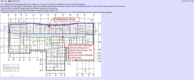

In reply to Ideem, I agree. The problem is clearly more than a bad cantilever
detail. The steel frame would should have absorbed a couple of cantilevers collapsing
without the building coming down like it did.
As to some reasons why, all of which have been quoted by others previously:
1. Bolts were shown missing in one post.
2. A weakness was identified where hardly any steel beams cross the building
longitudinally just below line 10.
3. The failure photo below show a large section of the building falling virtually intact.
4. Steel was seen in previous post not crossing steel beams at the studs, but stopping at them.
Were many bolts missing in addition to the clear design errors on the permit plans? The practice is
normally to place a couple of bolts in the beam as it is set, and before the floors are added, to place the rest.
Though the failure may or may not be related to the cantilevers, it is clear that many much more serious problems
existed at lower levels as illustrated by the photo below.
By the way, these beams are not composite steel beams. I checked a few and found that the studs were not
sufficient for composite action. They merely attach the slabs through the deck to the beams.
Regards,

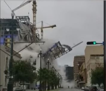

Sorry. I do not know how to upload my image. Look at the failure video for part of the building falling virtually undamaged.
The building failed longitudinally along line 11 next to the elevator and stair towers. There are hardly any steel beams crossing the line from line 10 to line 11 as noted above.
The failure at line 11 separated the building into two parts, that which stood up and that which failed. This mass of falling concrete would be more than enough to cause the failure of the steel structure below considering the weakness of the lightly connected sections of building.
Note that the portion that fell was no longer connected to the cores for lateral stability. Connections of the beams to columns were likely shear only with little moment resistance. Nothing was holding it back but metal deck and steel reinforcing. Once it started to lean, failure was assured.
Failure below is still a possibility but a frame by frame look at the failure video leads me to suspect it occurred from the area of the top down.
One last comment before bed:
A post by Tomfh on 14Oct19 at 23:04 clearly shows that there is no top reinforcing bars crossing line 11 beam which is seen in front of the workman by himself in the green shirt. You can see the line of Nelson studs on top of the beam where the reinforcing steel stops.
The reinforcing steel should have extended over the beam on both sides for negative moment and may have helped stop the progressive collapse but for some reason it was misplaced.

Please show me where the steel going between 10 and 11 is. I have looked at the plans, a good mark up in green forum member and photos and cant seem to find it.
I am getting older, maybe I need stronger glasses!
Regards,
I assume this is the post you are looking for? It is from JAE on 10/15/19 @ 17:06 (not sure if this time is location specific in the world or if it is GMT).

Thank you, that was the post I was looking at.
IceNine, I see no reinforcing steel across the 10 line down to the 11 line in the above repost by BadgerPE. Am I missing something?
Also I was discussing this area with a very large building contractor today and it was his feeling that
the crane attachments would likely damage the otherwise un-reinforced strip as the crane moved under load, possibly breaking spot welds.

Looking at link of video, thanks JohnRBaker and dold, at start of thread
Unfortunately the video starts a little late to capture start of collapse, rewind and pause at 0 seconds. If video was shot from North, take a look at the North Elevation, there appears to be a sliding cantilever deck usually used during construction (not permanent structure) , yellow in color, that was originally supported by the third level from the top that has already displaced to nearly the level below, less than a second into the video the deck has already reached the level below. The sliding deck appears to be supported on the edge by a thin cantilever concrete metal deck slab. There does not appear to be any reshores below the sliding deck at the concrete slab edge.
Photo posted by GPR Tech on 24 Oct. 2019 shows similar deck, does not appear to be reshores under this one either.
No reshores under a thin cantilever deck seems highly unusual to me, and I have designed supports for several of these types of decks.
Can't tell from the video if collapse is just now reaching the cantilever deck or the cloud of dust beyond is just now reaching from the collapse of the deck.

If you look at the second photo in Tomfh's post, 14 Oct 19 23:04, you can see rebar crossing the 10 and 11 lines.
It is hard to see because the rebar is parallel to the deck flutes, but if you look closely, it's there. There are two rows of bolsters on the deck and you can see the rebar extend past the beam with headed studs closest to the man in the green shirt.
None of this rebar is shown in the permit drawings.
