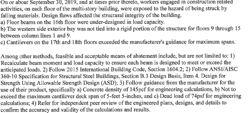

So far OSHA has released a Citation and Notice of Penalty which contain some hints; I see no formal report analyzing the failure from them.
I tried to find this on the OSHA site; this is a link that a news agency posted:
from
Of course it is scanned and not searchable.
An extraction by Nola.com:
An image of the scanned-to-PDF OSHA Citation against Heaslip Engineering, LLC:
