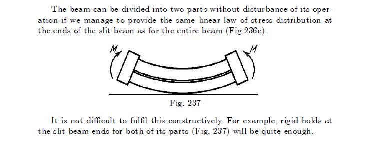

DEAR NPR99,
- THE PLATE DOES NOT TRANSFER ANY FORCE..THE ASSUMPTION ,' THE RIGID PLATE DISTRIBUTES THE BM TO THE FOUR RODS ' IS NOT CORRECT AS LONG AS SHEAR EXISTS..
- IN ORDER TO ASSUME THE FOUR RODS BEHAVIOR WILL BE COMBINED BEHAVIOR AND THE MOMENT OF INERTIA WOULD BE THE INERTIA OF THE ASSEMBLY ( AS PER UR CALCULATION ), THE BEAM ASSEMBLY SHALL SUBJECT TO PURE BENDING AND THE INDIVIDUAL BEAMS ( IN THIS CASE FOUR RODS ) SHALL BE RIGID CONNECTED , AND THE SECTION AT THE TOP AND BOTTOM ASSEMBLY CONNECTIONS SHALL ROTATE RIGID..
IN ORDER TO CLARIFY AND JUST FOR SHARING THE KNOWLEDGE , I COPY AND PASTED A RELEVANT WORKED EXAMPLE FROM THE BOOK (Advanced Stress and Stability Analysis BY V. I. Feodosiev )
I HOPE THIS RESPOND ANSWERS YOUR QUESTIONS AND DOUBTS..
GOOD LUCK..

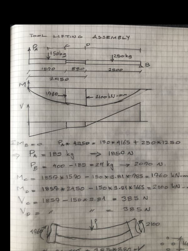

@Desertfox… one thing I can’t follow is how you have calculated the bending moments per your diagram? I’ve been staring at it and playing with my calculator for half an hour but can’t figure out how 2100 Nmm x 10^3 has been reached. Please can you clarify?

I took moments at the point loads, so to find the bending moment at the point where the 250kg acts,I took moments to the left of that point so :- F * cos10 * (785+2919) - 150*9.81 * cos 10 * 2919 = bending moment where the 250kg acts. Similarly to find the bending moment where the 150kg acts I take moments to the left of that position so : F * cos 10 * 785 and that’s how I got the original two values, the bending moment diagram between the two points is a straight line and so I drew a bending moment diagram to scale and measured the value from the diagram. Hope this helps
Mark, what sort of experience do you have ? The calc was well laid out (unless you're saying df dropped a clanger).
The clac shows that the RH end in supplying the rest of the weight reaction ..
loads weight is (150+250)*9.81 = 4000 N (I think we get here, to forces in N, whether the bodies mass or weight is given in kg)
Lift is 1857 N, so RH reaction is 2143 N

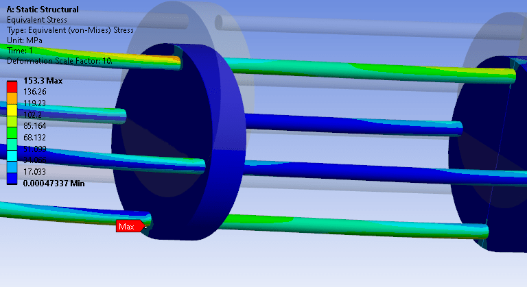

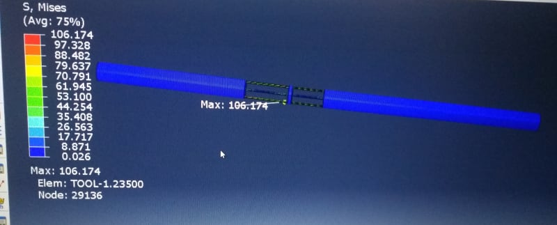

I still feel that my assumption not totally wrong if not completely accurate. The behavior of rods will be in between the theoretical attached rigid plate and no plate like the combination of figure 237 and figure 36 of your post.
This is not just thought. I actually ran a simulation today (thought was not getting out of my head as a hard core analyst). I modelled Tool as single solid part considering rods "firmly" connected to the plate and both bodies. Adjusted mass of both bodies as given in the sketch by OP. Overall mass = 0.415tonne due to weight of plate and rods. Then fixed the lift point and only vertical point constraint of 5deg rotated tool at the other end where it just touches the ground. Applied only gravity load with elastic properties.
The von Mises stress at the bottom rod (my previous post image of plate with rods) at 2054mm from LH is 106MPa peak and 90MPa peak at 2453mm from LH. So what is assumed by me and rb1957 that the plate plays role in the transferring the forces is correct. Further this proves what rb1957 is saying that physically the plate will impart axial forces on the rods as couple. But there is something more to it.
From LH total mass supported = 4071.2N, then vertical reactions at close to 0deg, RL=2035.58N RH=2035.58N. Then 2035.58*2054-(150*9.81*(2054-1570/2))=2.314E6Nmm. Then M/d=2.314E6/166=13.938kN. Then the axial stress in the rod = 13.938kN/201.06mm^2=69.33MPa which is not close to 106MPa? rb1957 already shown the calculation for 90MPa at 2453 from LH.
But there are other things in the results. The rods at neutral axis not playing any role much but the stress is not entirely zero, either. As opposed to theoretical consideration of 90deg and 270deg rod-neutral axis rods will not be playing any role. Same is said about the rod bending. The 484mm length part rods are bending which is why the results are not matching with 69MPa. There is clearly bending stresses in the all 4 rods of 484 length. The behavior is in between as I said above. For the 369mm length rods, the bending component is less but it is still "bending" "collectively". May be the rods are "firmly" connected that is why this may happen, you say. But I think even if, lets say, rod and plates or bodies are not attached "firmly" (there is some gap between the rod, plate and bodies as gap in rods and holes) after some relative play, rods are forced to dance together.

It is true that the behavior of rods in this case, will be 'in between ' .. However, engineered calculations shall be based on MINIMUM ENSURED , GUARANTEED level.
I am not sure what kind of simulation you have performed but in this case , the buckling of compression members (top chord), second order effects , shear will affect the behavior.
If you look to the picture Fig. 237 of may previous post, the two elements are touching , so having single curvature ..In this case, the top, bottom chords would have different curvatures.
Regarding the moments and shear developing at rod assembly, i reviewed my hand calculation and pasted below;

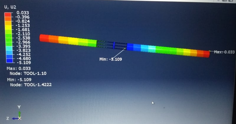

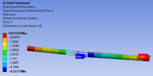

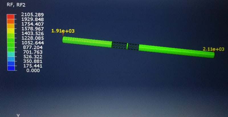

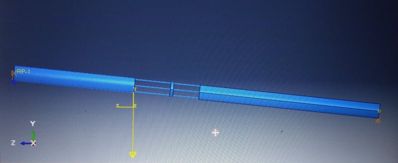

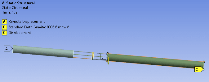

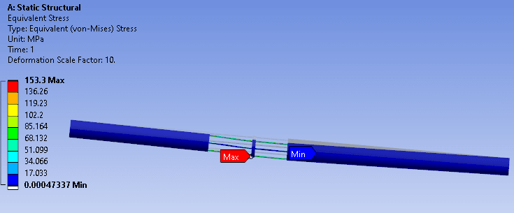

Here are images from simulation.
Model-RP1 is constrained in all DoF but RX free. Other side vertex touching the ground is fixed in Y only. Gravity applied in -Y. Tool body rotated by 5 deg wrt horizontal
Displacement
Reactions
Stress
Different results in another software but overall behavior is same as above.
be careful with von Mises stress ... it hides the -ve stress.
is your FEA supporting my "back of a fag packet" calc ... then 16mm fasteners have a high margin ?
