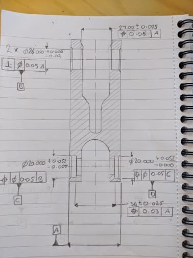

Hi guys,
Can anyone point out any flaws you see with these call outs on this drawing.
The idea is the best way to control and dimensions 4 Cylindrical pockets / with the front and back being as close as coaxial as possible.

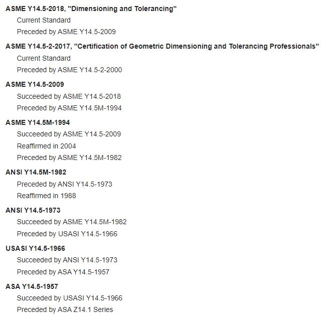

The critical missing info is what year you are utilizing. There are large differences between each revision, it matters quite a bit.
Perfect ,
it will be the current standard i presume , which i will double check.
These are new prototype components so i would assume the latest standard would be used.
Are you allowed to use old standards for new parts ?
Ross
Who develops the drawings for these components? I am guessing by your questions that you are design responsible. In that case, it is up to you to determine the standard. If not, then you must check with your customer. The latest version is 2018, yet many companies are still utilizing 2009. Even still some companies utilize the 1994 version, and its not uncommon to see legacy parts with drawings compliant to 1994 or older.
There is no requirement that one utilize the latest standard for a drawing of a new part - I could make a brand new drawing and utilize ASA Y14.5-1957 if I wanted to, however it usually behooves a company to try and update their practices to the latest standard because of improvements, clarifications, and added controls. That said, whatever it is drawn to must be utilized to evaluate said drawing (and for inspection/etc..) unless noted otherwise by the design responsible party or on the drawing itself. Sometimes older drawings cannot even be interpreted with newer standards - for example Symmetry and Concentricity have been totally removed from Y14.5-2018, a drawing compliant to Y14.5-2009 that utilizes these controls would have to be interpreted with the original standard, even if allowed to do otherwise by the aforementioned methods.

Going with either the latest version or 2009 version . Would the call outs in my sketch hold up with you guys ?
Ross
Without nitpicking too much (cough, attachment of the datum feature symbol A, cough) it will certainly accomplish what you want - though the top frame (PLTZF) of your composite tolerance cannot have a reference to only B. You must the same datum feature references and in the same order of precedence in each frame. If you truly want to do this, Multiple Single Segment would allow that. You also have several frames with the same size tolerance zone, just with different datum features - this is relatively redundant (ie: if a hole conforms to 0.03 position to |A| it will certainly conform to 0.03 datumless position) and even if its not wholly redundant (ie: 0.05 position to |B| and 0.05 position to |A|B| - assuming they were applies in a multiple single segment, since as I said its not valid for composite) I'd question why you needed such refinement.
There are other methods, including utilizing a single profile tolerance combined with "HOLES INDICATED Y" or some similar note if all four holes can be held to the same size tolerance zone in basic location to each other instead of establishing one set of holes as datum feature B and controlling location from there.
Please nitpick,
Every ones help and knowledge is fantastic.
Holding my Datum B to say 0.05 to A , does then in turn control the true position between the pockets and the perpendicularity between the Datum Feature A ( Plane ) to Datum feature C ( axis combined by the two top pockets )
What i am looking for is the pitch between Datum B + C to be tolerance differently to the parallelism between the two axis .
I don't think i am understanding composite tolerancing enough.
Which something i will have to look at .
Ross
The top level of a composite tolerance controls both orientation and location both to the datum references and to each other.
Lower levels control only orientation to any duplicated datum references and orientation and location to each other.
When there is no reference at a lower level to any datum reference then orientation and location are controlled only to each other.
It is only sensible when each descending number of datum references is accompanied by a decreased tolerance allowance.

Hi guys,
Does this 2nd attempt make more sense
The reason the back two are 2x and the front is not,
is the depth of the front two would very difficult to check them as cylinders as they are so shallow.

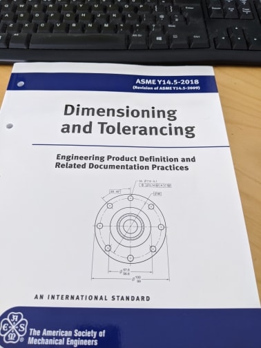

It is much easier to understand this if you buy a copy of the relevant standard and read it.
3DDAVE,
Thanks for the previous help,
I have purchased this book yesterday so i have a lot of catching up to do .

Rwelch9,
Allow me to share some loose thoughts that come to my mind after reading through this thread (I see that you started multiple threads which all seem to circle around the same part/drawing):
-- The fact that you have bought 2018 version of Y14.5 does not have to mean that the your customer uses this version of the standard too. Each version is different from the others, so I would really encourage you to clarify this with the customer before you go any further.
-- It is very difficult to say whether certain dimensioning and tolerancing scheme is really correct just by looking at the drawing. GD&T philosophy is that dimensioning and tolerancing should really be based on how the part functions. In other words, you may have a perfectly looking drawing from semantic point of view (all callouts defined on it will be fully according to the rules defined in the standard), but the definition itself will be far from perfect, because it will not capture the functional requirements of the part properly. What I am trying to say by this is that to asnwer this kind of question one usually needs to know how the discussed part is oriented and located in the assembly. This greatly helps for example in determination if datum features have been selected correctly.
-- On your 2nd drawing, removal of 2X from the front shallow holes will not make the establishment of their axes any easier. The axes of each individual holes will have to be established anyway.
-- On your 2nd drawing, the perpendicularity tolerance wrt A applied to both front holes should be changed to position wrt A to avoid incomplete specification. Current scheme does not control mutual relationhip (spacing) between axes of the holes.
-- I would not give up on a thought to apply a composite position tolerance to both front holes (of course assuming it functionally makes sense).
-- If the drawing is in millimeters and you really want to follow the standard, you need to correct the way the decimal places have been expressed for almost every dimension. In 2018 version of Y14.5 you will find the rules for this in para. 5.3.1.
-- The diameter symbol preceding the tolerance value inside the feature control frame (FCF) shall be in the same compartment of the FCF as the tolerance value (i.e., no separate compartment for the diameter symbol is needed).
-- What about the 2 small holes coaxial with the front holes? Can they be controlled as a group relative to a global datum system (say, |A|B|C| or |D|, where D is an axis established from both dia. 20 bores) or does each of them must be controlled individually to its corresponding bore?

: regarding the book ( is there a vast difference between different one ) ?

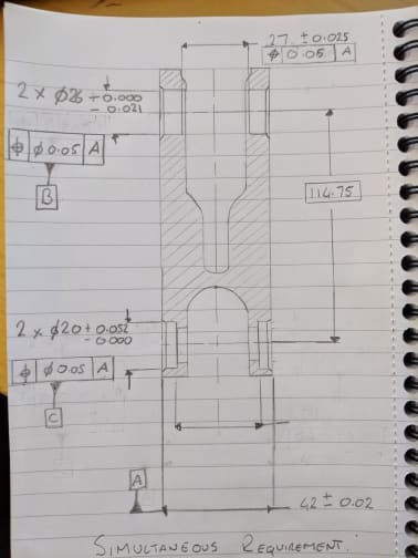

I am not sure I understand everything from your last post, so forgive me if this reply does not address all your questions well.
-- The relationship between 4 cylinders can be addressed by applying position tolerances relative to datum A only. There is a concept in Y14.5, called 'simultaneous requirement', that says that unless otherwise specified, the features controlled with position or profile tolerances that reference the same datums, in the same order, and at the same material boundary shall be considered a pattern. In your case the position tolerances relative to A only would create a group of 4 cylindrical tolerances zone (2 pairs of 2 coaxial cylinders) perfectly perpendicular to the datum center plane A and spaced at basic distance apart (which by the way is missing on your drawing).
-- Regarding the difference between different versions of Y14.5. Some will say the differences are minor, some will say otherwise. That depends on who you ask. In the parallel thread started by you about straightness tolerance, I gave an example of a difference between '94 version and higher versions. And there are more. For instance, '94 version did not show any examples of composite tolerances with more than 2 segments and many people literally took this as no-no for three-segment composite callouts. As you already noticed in another thread, newer versions of the standard clearly allow for this kind of callouts.
-- Yes, in addition to being a perpendicularity control relative to A, the position applied to 2 datum features B will also control axes offset. Perpendicularity tolerance alone is not capable of controlling the latter.

Updated Drawing trying incorporate you guys advice.
My question if this attempt at using simultaneous requirements. To create a pattern is correct.
Does that mean the bottom two cylinders together would have to be with 0.05 positionally of the top two cylinders.
whilst both set of cylinders would have to perpendicular to Datum A within 0.05.
Ross
If you are establishing datum B and C and not using them in other FCF's I think is useless.
Why do you need B and C?
Maybe am I missing something, but I did not understand their scope.
