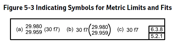

Let's consider fit tolerance as shown below captured from Y14.5-2018.
Take this dimension is for a tab width or a shaft diameter (assuming there is a diameter symbol), and the model flows down to CAM.
1. What size would you model it? 30, or something close to 20.970? What we actually do is modelling at 30. (Of course 2D drawing associates the model)
2. Which dimension would you call nominal? 30, or something close to 20.970?
@cinnamongirl: Nothing prevents you from modeling your parts at the least material condition. With my CAD package, I would model that feature at LMC and then when I place the dimension, I would add the qualifier MIN to that dimension. The number will be correct, and would likely be updated if your model is changed at a later date.

Nominal is not equal to mean is not equal to average is not equal to target or intent.
In fact, I would go so far as to say that it's inappropriate to compare these terms. They are all completely separate things. There is only one case where nominal and average are the same: bilateral tolerances like 1.00 +- .03. Yes, that case occurs frequently. A lot of confusion stems from applying this idea everywhere, though.
As an example, a nominal 1 inch pipe thread doesn't even have a 1 inch dimension on it anywhere. Nor does a nominal 2x4 stud have a 2 inch dimension on it.
Another example, a nominal 1/2 precision shaft might be specified as .4995 - .4998 per the ASME fits and finishes or perhaps .5000 -.0002, -.0005. The average of those two values is not equal to nominal shaft size and part made blindly to a nominal .5000 would be out of spec. In the later example of a dimension and tolerance, you would call the nominal value the .5000 part. That doesn't mean it's the middle value. But where to model such a shaft? Good question. I would choose to model this particular shaft at the maximum material condition.

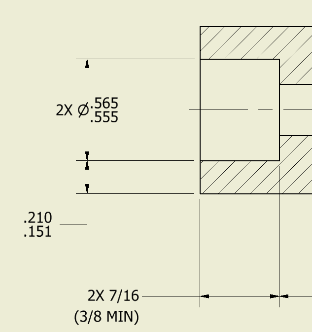

Thank you all for your responses. Here's how I chose to document a cylindrical coupling with a socket.
The minimum socket depth requirement according to the standard spec guide is 3/8", and the parts that were previously made have a slightly larger depth of 7/16". In order to maintain some consistency with the new parts we will be ordering I modeled my part with a socket depth of 7/16 inches, dimensioned it accordingly and manually added the minimum requirement of 3/8" for inspection purposes in parenthesis. Does this meet CAD and dimensioning standards?
An outside machine shop will be using my 3D model to CNC the parts but I want to leave some indication of the MIN requirement from the spec sheet in the drawing.
(by the way, for the other dimension requirements in that image, shown in limits, I used the average of each limit range to build the 3D model)
