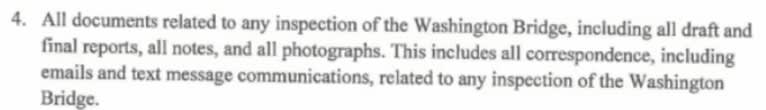

Part of the letter includes:
Any time I've provided forensic reports, I've completed them on my laptop... and with technincal material, there may be more than half a dozen drafts. Once I've completed the report, I then uploaded it to the project file (This occasionally would irritate IT guys, but I could accommodate that). Most medium or large companies with an IT have a server system that automatically provided a daily (or whatever) backup. My approach only left one copy.
I do that with all reports that I've prepared for other companies.
There is a rather unfortunate practice in some government agencies that when a consultant tells you his report is going to bare bad news, you tell the consultant to submit a draft copy (and never ask for a final copy) This is done because many FOIA laws exempt drafts. I worked for a state agency for a time and saw this practice first hand.
Sometimes it cannot be avoided such as, "...including all drafts." That's pretty specific. If required to provide a 'draft' I would only copy it from lawyer to lawyer to maintain attorney-client priviledge.

https://www.wpri.com/target-12/legal-battles-and-delays-why-washington-bridge-repairs-have-taken-so-long/[/URL]]State highway officials were well aware five years ago that the westbound side of the Washington Bridge was in bad shape.
NBC 10 I-Team: Draft report analyzes Washington Bridge, but makes no recommendation. by NBC 10 NEWSThu,port which is att February 22nd 2024 at 3:56 PM Updated Thu, February 22nd 2024 at 6:42 PM
This report included a draft copy of the engineering report, which is planned to be released in a few weeks. Copy attached to this message.

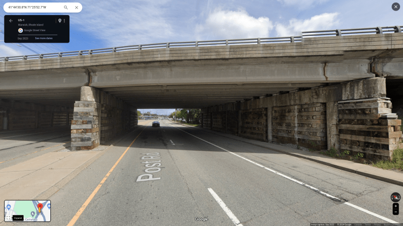

Google Maps
There is nothing more permanent than a temporary fix that works.
Sym P. le - FWIW, That's the Route 37 overpass. They are currently working on replacing all of the bridges along Route 37. This temporary shoring was done as part of the work to hold off on replacing this span until later in the project schedule. The contractor that initially won the job recently went out of business, which may explain why this bridge section hasn't been replaced yet. They dragged their feet on that job hoping for a miracle to save their butt. The new contractor that took over seems to be working slightly faster than the previous one.
Ironically, that contractor went out of business shortly after losing the bid to do work on the Washington Bridge. Here's the owner's middle finger to RIDOT as his company was falling into the grave.
