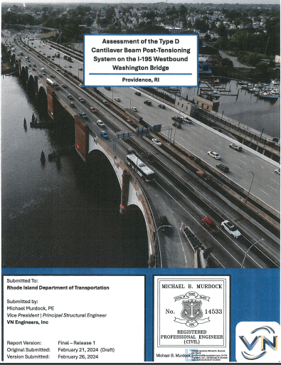

The failed anchor rod is part of the center span. I don't know which pier is involved. There is an east and west span so it will be interesting to learn if deterioration is similar on the alternate span.

Big question - why are so many bridges in rust areas not designed with obvious runoff paths on all structural members. I see i-beams with sharp corners at the flanges to the webs and dirt just piles up on there, trapping moisture and salt. Almost always when I see a rust hole it's right there. I know the plan is for the gutters and drains to work, but they don't seem to work nearly long enough.
