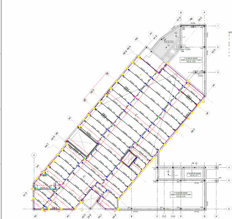

I don't mean to rant here but I must ask the structural engineers out there a few simple questions that are getting on my nerves. First I've been a structural steel detailer for 33years and I've never seen the industry so sad as I do today. May I ask how it is you feel comfortable releasing your design contract drawing without a single dimension, all while the architect has a full blown grid layout? Is this pure laziness or am I missing the reason behind doing this? Today I had enough of seeing this so I stated to the fabricator, who was requesting a price, "Can you imagine I release my shop drawings for fabrication without a single dimension"? Here's another one....I have a small job that's been on going for TWO YEARS and it's now on it's 6th redesign. I finally had enough and being nice I asked the EOR why 2years later we are moving steel to attach to existing col's. His response was, "Because existing conditions did not allow us to sit on the wall as originally planned". My response was, "Aren't you the one that provided the original building design drawings but 2years later you're now realizing this is a problem"? All I heard was.."well...well". I'm sorry but I'd like to do nothing more than form a committee where we can report this. It's my opinion that more than half the engineers today should not have a valid professional license to practice. Not that I want harm for anyone ever but the industry has turned into a disgrace, but my bet says all PE's will have some validation why it is this way...no? Lets see the excuses come.

Was asked to see such a case of no dimensions. Here's one. Not a single dimension on any plan and they all were like this. Not even a set of architecturals accompnaied the structural set. Sorry I'm not posting the title block and naming specific parties that release this work. Job was a no start right off the bat then once the info was provided they discovered gas pipes not known to exist and that now was a year ago and the job died.

I do see dimensions on both of those drawings though...

The two pictures I posted violate that. Beams framing a stairwell, almost no eor gives these dimensions but the above states "location of all members". Another violation. Then during submittal I'll try to figure out their location from the architecturals and finish work but I'm not responsible for this and I always state "PLEASE VERIFY" with a clouded flag. The drawings almost always are returned ignoring this.

@dauwerda if you see column centerline dimensions on those drawings that satisfies the AISC spec...then you're a god. They don't exist

Ken, I see the 2 drawings you submitted and agree it would be far easier to detail the parts if someone had dimensioned the drawings more. But I do see dimensions in both drawings. I was mainly curious about not a single dimension but now you are saying a single plan dimension. Now that I have seen. But if someone has to spend time dimensioning the drawing, so be it. I do not design the beam length to the 1/16", I design it to a 3" multiple generally. So minor changes can occur and it does not change my design.
@Ron247 in my first post I did use the term "grid layout". But to be clear dimensions I'm meaning what every steel detailer will say is priority we need to even get started....the grid layout, or column centers. I honestly think that would have jumped out at anyone looking at those pics cause it's the first thing jumps out at me.
Ahh wait a minute..my bad. The first pic I posted the fabricators bid set he sent me. Take note the red dimensions...doesn't look like part of the contract set does it? It's because it's the fabricators bid scale dimension for pricing he marked up the pdf. Nobody even detected something fishy there? lol. Even the yellow is his take off for connection material. Take out what is obviously not part of those contract drawings and look at it again.
