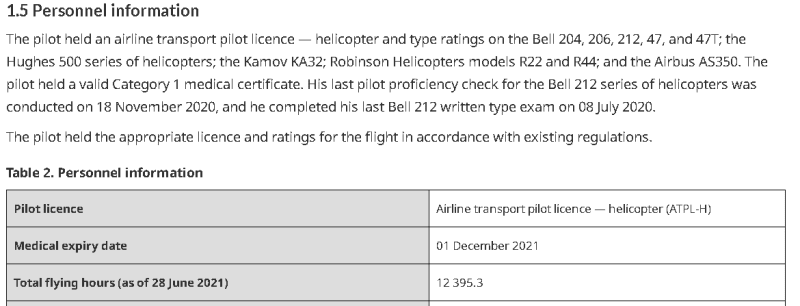

This was a tragedy in my neck of the woods. I really hope that this goes down as learning example at colleges and universities, because it sure took a toll on the community. Check out the variety of type ratings and the pilot's hours. He was no spring chicken.
