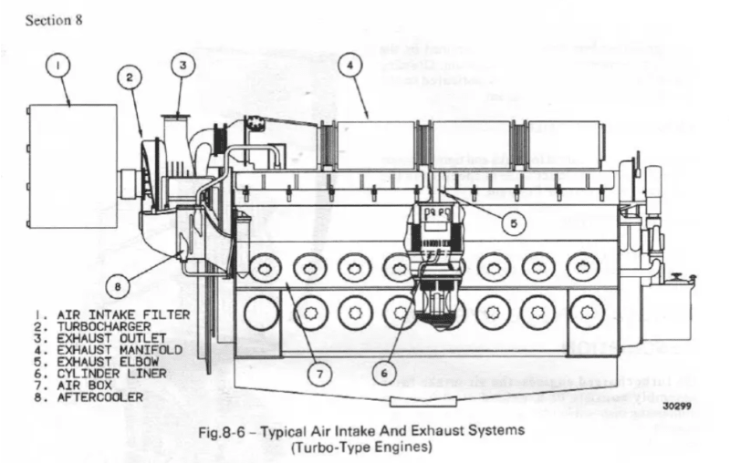

Background: I have an engine that I've received into my fleet that smokes at full power. These engines are essentially new and confirmed to be in good operating condition by the manufacturer. Everybody else's stumped so I get to take my turn at it.
What I have found is that the engine is installed very close to the after bulkhead of the engine room and the air filter box was modified to fit in this space. During the modification, the radiused inlet to the turbocharger was removed to space constraints. It is my belief that the squared off entry is choking the turbocharger for air.
Now I need to figure out how to correct this issue with limited space. I thought about projecting the inlet pipe into the air box and flaring the end of it. Much like a velocity stack on an old carburetor.

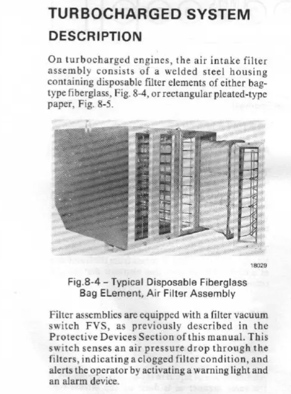

-The air filter housing was supplied by the engine manufacturer with 4 filter elements side by side with a straight through configuration. The installer cut the supplied housing in half down the centerline and butted the two halves together, and installed the outlet in the side to make a Tee shape.

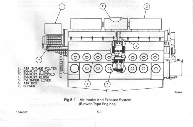

-The engine room previously had 16 cylinder 645 series roots blown engines, they were replaced with 8 cylinder 710 series turbocharged engines. The horsepower is the same but I suspect the air demand slightly higher in the current configuration.

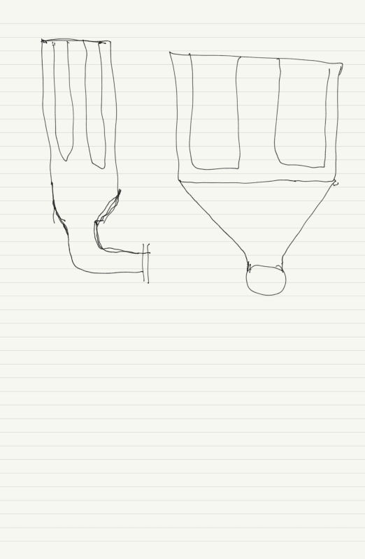

After reading recommendations, it sounds like by best solution is to build a duct perpendicular turbo inlet. Place duct outlet with radiused edges in side of duct so that it is 2*D from any side (16 inches minimum duct size). Install air filter box so that it faces centerline of vessel. If space does not allow I may require a U bend and place it parallel to engine.

Here is the Roots blown configuration so you can see why air filter content became a problem during conversion.
Abstract on the turbocharger from Wiki on the 710 series engines:
"Unlike the 567 or 645, which could use either Roots blowers or a turbocharger, the 710 engine is only offered with turbocharging. The turbocharger is gear-driven and has a centrifugal clutch that allows it to act as a centrifugal blower at low engine speeds (when exhaust gas flow and temperature alone are insufficient to drive the turbine) and a purely exhaust-driven turbocharger at higher speeds. The turbocharger can revert to acting as a supercharger during demands for large increases in engine output power. While more expensive to maintain than Roots blowers, EMD claims that this design allows "significantly" reduced fuel consumption and emissions, improved high-altitude performance, and even up to a 50 percent increase in maximum rated horsepower over Roots-blown engines for the same engine displacement. But, unlike the earlier 645 and 567, which could use either turbochargers or Roots blowers, EMD's clutched turbocharger is an integral part of most 710 models."

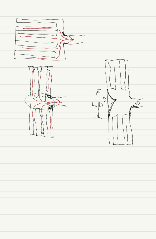

The Air filter I assume is as below in the sketch with 4 in line. Redlines is Air flow.
The modification looks a bit basic for sure so the green area is your issue I think.
So maybe one option is to add volume to the middle and maybe a guide vane. And make the curved inlet smooth with the front plate.
Get some incense sticks or some big fat Cuban cigars and see what the approach air flow looks like.
That 3rd photo shows a pipe projecting well into this filter housing, but its end is capped off ? How then does air get into this projecting nozzle ?
The ID of the inward projecting/reentrant is rounded. The radius seems to be about equal to the pipe wall thickness. The angle of the 3rd picture has the viewer looking straight at the rounded entrant. This may give the appearance it is capped.

Thanks for that Latexman, that optical illusion got me.
This projecting inlet essentially incapacitates some 2/8 = 1/4 of the total surface area of the 4 filter elements. So, if you keep the feed pressure to the compressor side of the turbocharger the same, air flow must drop to (3/4)^2 = 9/16 = 55% roughly of that for a flush nozzle.

There is no reason why this filter box needs to be in this cramped space right in front of this turbocharger. It could have been located in some area where there is more room, and have a one size larger filtered air feed pipe routed from the filter box to the turbocharger compressor feed with a few piping elbows. This way, you could have used used the standard filter box configuration.
Good idea GV! Being further away can mean more twists and turns. I’d back-calculate the diameter to give less dP than Mnfr’s std. The one diameter RoT may not cut it here. I’d be sure.
Did I read two engines have the same issue? So, would an inlet air header to both make sense?

Will need a new box for sure.
Maybe something like this?
