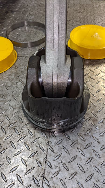

Bonus question: How many have seen a cast steel piston from a Ford 60? Steel pistons are back too.
The steel pistons were reintroduced by Mahle under the Monotherm name. Here is one from a Cat:

TugboatEng - Nice picture illustrating the teepee shaped small end of the connecting rod. The lower half of the pin bearing bore has more area for combustion gas loading compared to the inertia loading on the top half. The piston bosses are moved in at the top for additional bearing area and reduced pin bending. The strength to weight ratio of steel is better than aluminum especially at high temperature.

I always wondered why the ends of the rods were tapered. I just assumed it was for weight savings.
The net effect is a weight savings by allowing a shorter pin with a larger I.D. to carry the loads piston loads. Diesel allowable pin bore pressures have more than doubled in the last 60 - 70 years from perhaps 60 ksi to 140 ksi. Fit, finish and some design tricks account for much of the increase in bearing surface loading but the bending stress limits of steel have remained pretty stagnant. So moving the firing load areas closer together really helps to reduce the bending stress and the amount of steel needed to cope.
