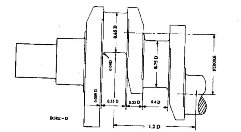

just an update on the subject I started up about 3 weeks ago here's a few examples of what I was looking for
are those proportion a form or parameterization
if so what is the terms used so i can search more info on the subject
i am looking for proportions in relation to the bore size ( bore to ratio features sizes ) for the "cylinder block" and "cylinder head" features and dimensions
any publication with those kinds of formula!
i got lucky and found those pics by looking for something else and these came up
P.S. if i am a pain let me know as i don't want this subject to stretch for ever just want to get as much info as i can on this thread
Steve
While it will be found that certain of those dimensions may fall within certain relationships to other dimensions, an attempt to design an engine strictly by rule of thumb is sure to end in failure.
Changes to certain engine parameters (e.g. compression ratio, whether the engine has forced-induction or not, rev limit, piston speed and acceleration at redline, etc) will shift those relationships, for example.
You HAVE to crunch the numbers, and even in the old days, they crunched the numbers. They may not have had modern analysis tools available, which meant they had to allow for bigger margins of safety, but they did indeed crunch the numbers the best they knew how to do at the time.
I can tell you for sure that the crankpin journals in the last motorcycle engine that I had apart are not 0.65 times the bore diameter, and the main journals are certainly not 0.35 times the bore diameter in width. And the piston skirts nowadays in such an engine are much, much shorter and do not form a complete circle at the bottom - the unnecessary weight is cut away.
I'm guessing that the sketch you found is for a heavy-duty engine designed for higher cylinder pressure, and much, much lower revs. And perhaps those dimensional relationships are appropriate for an engine with that service. But ... you have to crunch the numbers.
