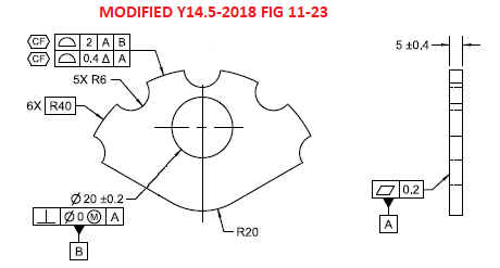

Please ref to the figure below, two questions need help:
1. Is it valid to have a Free-State symbol within the flatness FCF? Since the restraint note on the drawing will override the Free-State default condition, so I will say No, am I right?
2. What's the meaning of the 2nd segment flatness callout?
Thank you for the help

In addition, when applied to nonFOS use of <CF> can do things which profile alone cannot necessarily do. Consider the below modification of Y14.5-2018 fig 11-23 (apologies for the roughness, I did it very quickly to show a CF application where the individual features as well as the resulting continuous feature are nonFOS). Without the <CF> symbol and instead say "nX" notation for a pattern I'm not sure it would be necessarily required that the dynamic profile tolerance zone for each arc progress in the same direction or with the same magnitude as the others. Use of <CF> makes this clear.
This all said, I found a strange portion of Y14.5-2018 inside one of the paragraphs devoted to dynamic profile. At the end of para 11.10.3 (Dynamic Profile Tolerance Applied to the Lower Segment of Multiple Single-Segment Feature Control Frames) there is the verbiage which reads "NOTE: Multiple features are considered to be a single feature unless “INDIVIDUALLY” follows a separate single-segment profile feature control frame." The accompanying figure is 11-37 which deals with, as the title suggests, a dynamic profile tolerance in the lower segment of a MSS FCF.
I'm not sure how one should interpret this. I don't think the purpose was to undermine the use of <CF> - in fact I think it would be detrimental to consider by default multiple features with a profile tolerance as a single feature, and use of INDIVIDUALLY would be conflated between its true use (breaking a pattern) and this suggested use (breaking a single implied continuous feature).
Something tells me there is an error here that was missed. I am interested in everyones thoughts on this.

In Fig 11-23, I think the grouping mechanism for the 0.4 dynamic profile is the <CF> symbol. In Fig 11-37 I think the grouping mechanism for that 0.4 dynamic profile is the all around symbol. So, I agree that the note at the end of 11.10.3 is a mistake. I think deleting that note would be a good change.
The work to be done with grouping affects the 2 mm profile of a surface specifications in both figures also. Since profile of a surface can control coplanarity and also stepped parallel planar surfaces, I don't think features such as those shown in Figures 11-23 and 11-37 can be said to not have similar feature relationship control. Since no explicit rule is provided for the coplanarity or co-stepularity (;-)) control, that assertion will not come without opposition. The good news is that grouping should be greatly clarified and improved in the next version of Y14.5. The bad news is the time we all have to wait until that next revision will be released.

You make a good point, the grouping of features with all-around or all-over does throw some complications into the mix. What about when we consider another case of multiple patterned features controlled with profile, say if Y14.5-2018 fig 11-37 was instead a pattern of 2X features (similar to 11-26) would you expect the dynamic profile tolerance zones to progress together?
Yes, from the consistency perspective this is what I would expect, unless INDIVIDUALLY is used, as mentioned in the note you questioned.
pmarc,
In that case lets take it a step further. Take my same hypothetical case, say we want to override the requirement for the dynamic profile tolerance to progress together but not the nX pattern on the lower segment which holds the features of the pattern in relative location/orientation. I'm not sure one could apply INDIVIDUALLY and expect to accomplish this, I would expect such notation to also break the pattern that holds the features in relative location/orientation. I don't think this is a contrived requirement - we regularly specify patterns of rFOS such as holes and expect them to satisfy their requirements for size independently while still maintaining relative location/orientation of all the features in a pattern.
Perhaps this just proves that the standard is missing one more level of "grouping" mechanism.

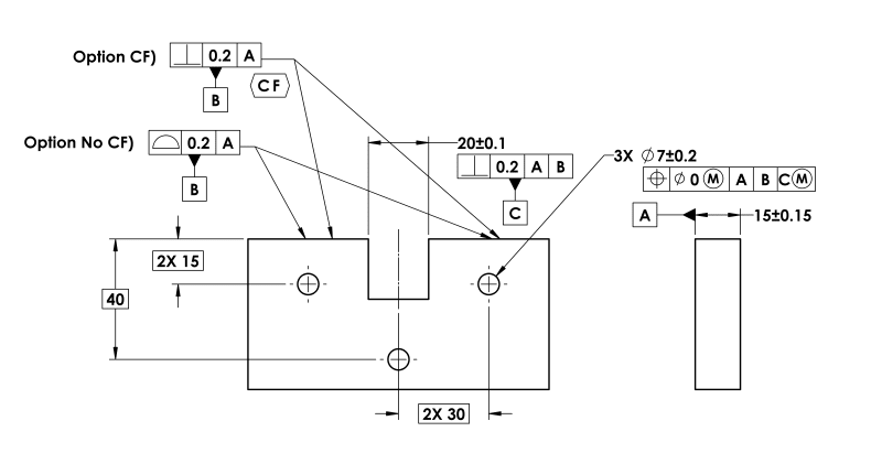

Consider a pattern of holes, perhaps used as a secondary datum feature on the part, controlled for position at MMC with reference only to the flat face which the holes are drilled normal to.
Many people are confused by this because position with reference to a datum is associated with location relative to that datum, and here we only control orientation to the DRF and mutual location+orientation between the holes.
For the sake of intuitiveness, let's allow to replace the position symbol with the perpendicularity symbol. That way it will be clear to everyone what type of relationship is expected between the considered features and the datum reference, and since the number of places (nX) specification is listed as a pattern creating mechanism, everyone will know that the holes must be mutually located within the tolerance zones. This will make the life of "suppliers with marginal GD&T knowledge" much easier, wouldn't it?
If we don't mind for form or orientation tolerances to control mutual location (coplanarity) when used with CF, why is there an issue with the mutual location of holes being controlled by perpendicularity when applied on a pattern?
Again, a bad idea.
Every concept becomes "intuitive" once understood. Expanding the standard on and on in to introduce more intuitiveness for people who don't fully grasp the basics doesn't make sense. Instead of creating an unbearable abundance of different tools and conflicts between general principles and special cases, make the definition of existing tools more rigorous, concise, and accessible.
A perpendicularity tolerance establishes a single tolerance zone.
How would multiple, not-coaxial, separate holes fit into a single tolerance zone in order to establish location relative to one another?
On the other hand, would multiple, nominally co-axial bores to accept a pin be allowed to controlled with a single perpendicularity tolerance when modified with CF? Seems like that would be a single feature being controlled by a single tolerance.

The comparison is between perpendicularity with CF vs. profile applied to the two surfaces that are defined as datum feature B. Perpendicularity is more intuitive than profile, I believe.
It is more intuitive because it is exactly the same tolerance needed if there was no notch in the middle of the part. No need to change to profile, just because a notch interrupts the feature.
That's the way I see it anyway. I am not going to bet on you agreeing on this one :-)

Consider a pattern of holes with position tolerance and an orientation refinement, not by the means of a composite feature control frame, but a perpendicularity second segment. The perp. second segment would create as many tolerance zones as the nX notation specifies. The tolerance zones would not be locationally constrained to each other unlike in the case of composite position because orientation controls do not locate features - mutually or to a DRF.
Dean,
The above example, specifically the difference between the two refinement options also shows why we shouldn't have an orientation control controlling coplanarity. Coplanarity = mutual location between different surfaces. The fact that a symbol is used that tells the drawing user to "imagine" that two separated surfaces form a single planar feature and that he "only" evaluates the orientation of that imaginary single surface doesn't change that fact.
That's "n" single tolerance zones. Position allows for a group under the "Simultaneous" DRF rule.
The use of CF over-rides the concept of "different surfaces" by explicitly stating that they are s single surface for purposes of applying the tolerance. An orientation control controls coplanarity of all individual elements of the single surface it's applied to. Why would you think otherwise?
Coplanarity of elements of a single surface is actually the form - more specifically flatness of that surface.
You can virtualize a single planar surface by "treating" two surfaces as one for the purpose of applying the tolerance but that is really nothing but letting in a location control (of features relative to each other) through the back door, because the single surface is a fiction. You are just calling usual things by names that are not intended to describe them. Why do that when you have another option and that is applying a characteristic that is intended to locate (among its other uses)?
Also, the gist of my perpendicularity example* wasn't to suggest it might work with the current definitions, but to show that not everything "intuitive" should be pushed into the standard.
Edit: *this is in the context of the original "proposal" to Dean to let perpendicularity applied on a pattern co-locate features.
