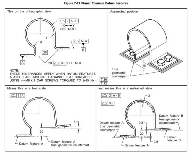

You might want to take a look at this example from the ASME Y14.5-2018 standard:
Check out how the 0.8 mm profile tolerance is applied in the restrained condition to datum features A and B. Additionally, the 5 mm profile tolerance qualifies datum feature B relative to A in the free state. I think this relates closely to what you were asking about.
Yes Burunduk, this is almost the case, thank you...one doubt: the right picture at the bottom, shouldn't be a "constrained" state instead of "restrained" state?
Thedesigner,
"Restrained" is the commonly accepted and standardized term to describe the condition in which the part is fastened or clamped against a fixture with considerable force.
"Constrained" on the other hand, most often refers to free state inspection - we say that the degrees of freedom of the part are being "constrained" by the datum simulation process, even when the inspection is considered to be "free state" and no considerable forces are used.
Think of it this way: constrained means that it's merely stopped. Restrained means that it's muscled into placed.
Hi, thedesigner75:
"Constrained" controls degree of freedom. It means relationships between multiple features. For example, BASIC dimension 20 in Figure 7-27 constrains distance relationship between datum feature A and B. In CMM, it means to find out best fits for datum feature A and B while maintaining a distance of 20.
