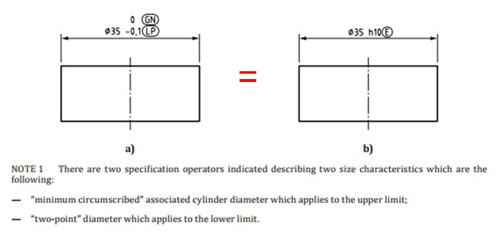

I'm trying to grasp ISO concepts and I would like to clarify some on my (most likely) misunderstandings:
A hole is dimensioned for size and location:
Ø40 ± 0.1 E (envelope requirement)
pos Ø0.05 (circle X) to A primary, B secondary and C tertiary
is the above scheme equivalent with
Ø40 ± 0.1 GX
pos Ø0.05 to A primary, B secondary and C tertiary
On the same token:
A pin is dimensioned for size and location:
pos Ø0.05 (circle N) to A primary, B secondary and C tertiary
Could its (pin's) definition also be written as:
Ø40 ± 0.1 GN
Thanks for any input and corrections your might offer.
These are not equivalent schemes.
One of the differences would be that in the scenario with the envelope requirement for size and with circle X(N) for position, maximum straightness error of the extracted median line of the hole (shaft) would be controlled by the size tolerance, whereas in the other scenario position tolerance would limit the extracted median line of the hole (shaft).

In the "pos Ø0.05 to A primary, B secondary and C tertiary" scenario the maximum straightness error of the extracted median line is limited by the position tolerance value.
GN or GX modifiers mean that the given size requirement applies to the minimum circumscribed or maximum inscribed associated cylinders.

GN modifier added to the size callout means that the size of the minimum associated cylinder circumscribed about the actual (extracted) integral feature shall be within 59.6-60.0. I would say this technically creates incomplete size specification because nothing controls how small the actual local sizes of the cylinder can be.

I am trying to think of a case that would warrant the 60.0 upper limit on local size (ISO), but not on circumscribed cylinder size (ASME). I haven't come up with anything so far. Can anyone provide an example?
