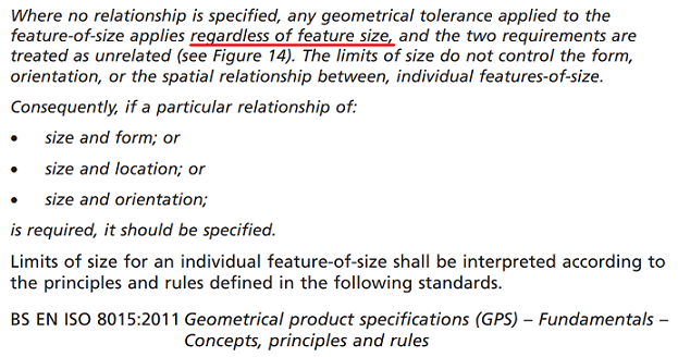

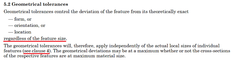

You could see mention of RFS in older edition of ISO 8015:
Interestingly it is seen as equivalent of independence principle, which applies by default anyway.
Even with 1985 edition obsolete, you could see RFS mentioned in BS8888:
Having the same meaning: geometrical tolerances and size tolerances are unrelated unless explicitly specified otherwise.
One could imagine with recent clean-up ISO decided to get rid of redundant requirement.
Also, as geometrical controls apply independently from size there is no need in any magical "boundaries" as well (unless specified otherwise).
Interestingly, in ASME, in absence of (M) or (L) RFS applies which means all geometrical controls are subject to independence principle by default. (But going there would be hijacking the thread :))
