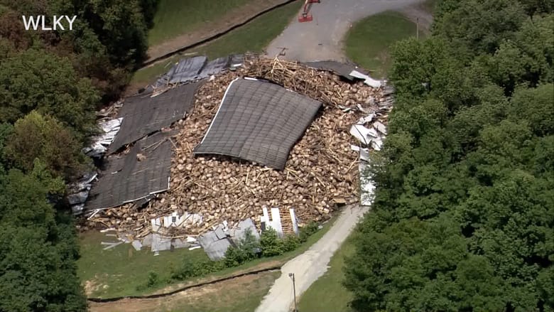

Curious as to why these structures are not held to the same building code as any other structure that requires human occupancy...
Because they don't require occupancy. No one lives or works permanently in them- so they are classified differently.
Besides, to what extent do you think the whisky industry influences the setting of building codes in Kentucky?

I think you will need to look at the date that was built and what if any codes applied. This was a problem that was known of. Nobody will admit that, but I bet this building has creaked and groaned for decades. I would think a layperson could have walked thru that and came out asking questions about safety. That was a $10million+ problem to fix today, and now provided they have sufficient coverage they might be covered by insurance. The whiskey stored might not be covered for its worth, so who knows how this works out in the end. Its great nobody was injured.
For many years, agricultural bldgs. and industrial bldgs., on their own properties were pretty much exempted from the bldg. codes in many locales. It was assumed that they did their own engineering for themselves and cared about their own assets, few people (the public) were involved, they cared enough not to endanger their own operations, they were self- responsible and self-insured, etc. As long as the last barn, warehouse, bldg. was still standing and performing o.k., they did the next one the same way, the old ‘has withstood the test of time’ thing. It’s probably actually a fairly stable storage system as long as every barrel or row or level is placed properly, and as long as the plank dividers are placed properly, witness the few failures they have had, or they would have change their ways. But, if any of the above is not done properly, or something happens to touch it laterally, with a feather, you can get what we see here. Let today’s code writers (LRFD, IBC and all) get their hands on this and you probably couldn’t get a barrel into place through all the bracing and connections.

I have always struggled with the past performance argument during reviews. There was a arena roof collapse in our area and during the review an underlying defect was found. I always think what if I had reviewed that a month or so before the collapse. Would I have found it? I am not so sure because that defect was only uncovered after vast amounts of the roof were removed and it became visible.

This report says it occurred whilst "having a wall repaired".....
If you click on the video then either wait or go to 2.22 you can see the inside of these things.
I like the pendulum where they load the warehouse in different locations to stop it falling down.... The text does sy these warehouses are particularly tall.

It's speculation to assume that the repair work was responsible, but it's a good speculation, as removing even a single board can compromise shear diaphragm capacity. If it was "on the edge", it wouldn't take much.
Update, Wednesday 4 July 2018.
The REST of the building has collapsed. All walls and supports are down now.
The story claimed the distillery tried to recover the barrels, but has very few removed. That surprises me: I would have figured an simple roll-away-and pickup-by-forklift would salvage many hundred barrels. I recognize that rolling/recovering/moving the barrels down low might loosen the pile and allow those further up to themselves move or roll. But you'd only have to work gradually.

Commenting on the building code issues, wouldnt most engineers classify these structures as Risk Category I structures if they were built today.
Looking at the pictures though, it appears to be a wood frame structure. lets do some napkin calcs. A standard barrel is around 60 gallons I think... so ballpark weight of each barrel is 512 lbs + self weight so... lets call it 550 even. Looks like the barrels are stacked 20 high. I cant tell their column spacing. It kind of looks like in the short side they have a column every barrel, but on the long side, it seems like perhaps its every 4 or 5 barrels. Just looking at the potential column loads with really rough trib areas, it looks like an axial loads in the range of 30-40 kips. Dont think I've ever done that with wood.
Sidebar: read the CBS article after I wrote this, the barrels weight 550 lbs each, huzzah! my guess work was right!
